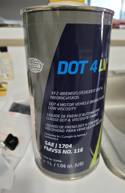

What would you choose to use if you were just weekend cruising and ripping around on backroads occasionally and garaging for the winter? Is there say an OEM + ? For my daily focus I had the fluid changed out with some Pentosin...actually let me snap a pic of what I used. Bought 2 extra bottles of it. Wondering if it would be decent in the FiST?

@akiraproject24 - That's what I bought. I'm not at all hard on brakes (pads last quite awhile). I had researched the difference and supposed benefit of low viscosity but it's been too long and don't recall the findings. Regardless I figured they stuck that in there for a reason. I'm wondering if it benefits ABS since it likes to pulse *very* rapidly.

That is exactly why Ford (as well as many other manufacturers) used it in these systems, it is thinner, so it moves through the tiny passageways in the ABS/nanny systems quicker (as well as not becoming too viscous in near 0*F or lower temps).
The thicker, more track oriented DOT4 Fluids will move much slower through these systems, slowing down the ABS/nanny reaction times, (and therefore 'pulsing') which for open track use is an added benefit, along with the higher wet and dry boiling points, and less thinning out with extreme heat. [wink]

That is FINE (and a great quality product as well), for your purposes.
Unless you use some racing compound pads (with or without a BBK upgrade), it will also most likely be OK for an occasional Track Night In America event (Pocono, NJMP, etc.) as well.
But, IF you ever do serious, multiple session, unlimited speed type open tracking, with racing pads, YES, you will need a better racing level fluid (or at least the Ate Typ 200 which Woods uses) to avoid brake fade, and/or 'spongy' brakes.

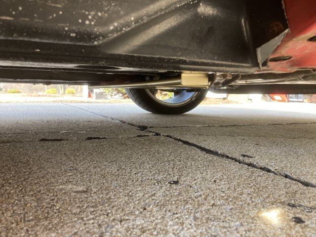

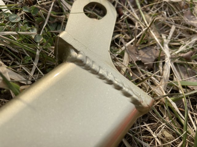

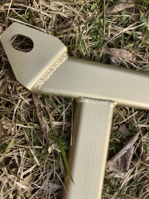

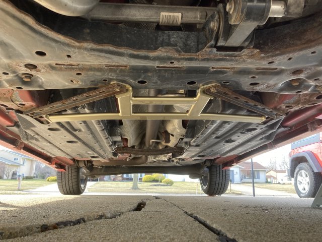

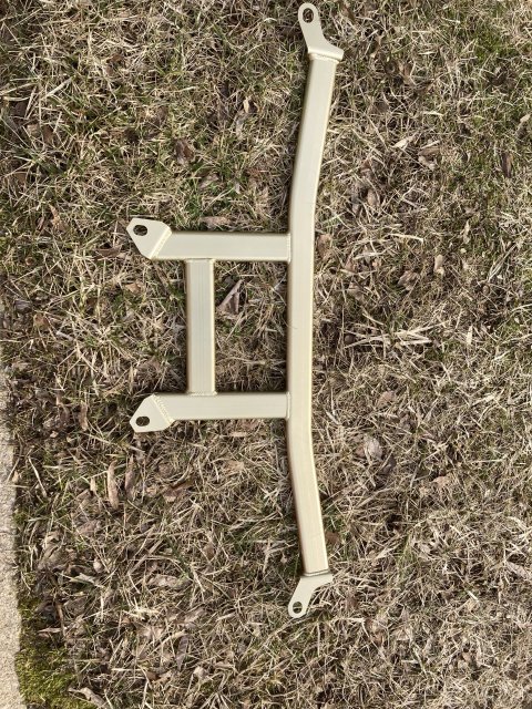

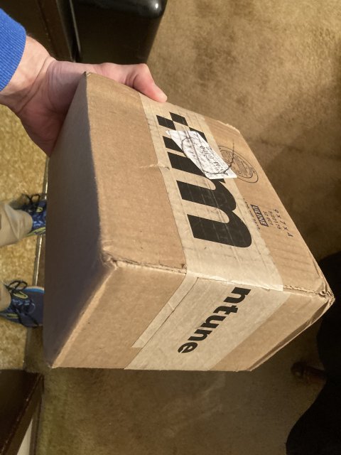

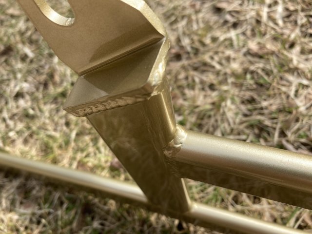

Put the Mountune brace on. It’s a nice piece of kit. Pretty satin gold, nice welds. Quality piece.
Removing the old bolts were a bitch though. Really torqued in there, almost seized. We’ll, my Dewalt wasn’t having any of that shit and ripped them out in 2 seconds. God I love my impact.
Interested to see what it feels like this season. Driving doesn’t feel any different, but it’s just driving. There are some nice esses at PIR I can try this out on. Only other thing I’m changing are tired as they’ve got little life left and I’m putting in B6s.

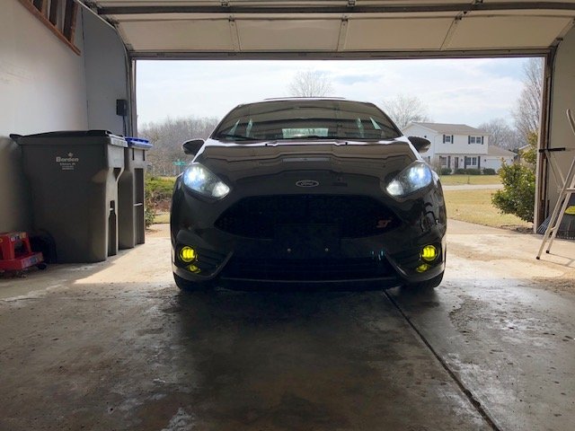

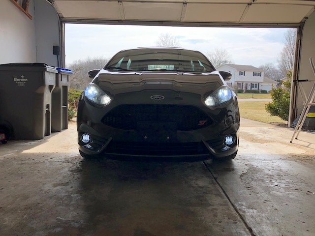

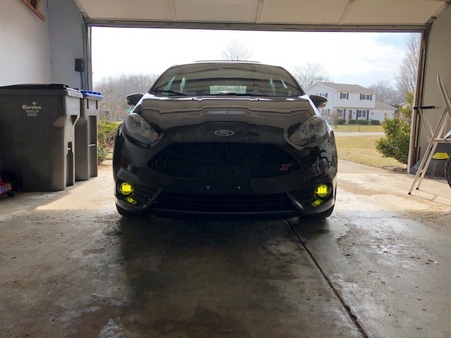

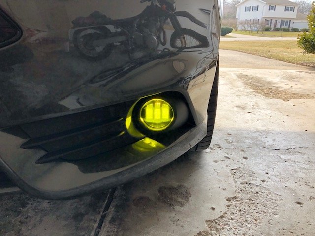

Hooked up my new fogs. They go white or yellow, and match the LED headlights better. Road trip tonight, so I'll see how they do. https://www.amazon.com/gp/product/B07WNSKS8D/ref=ox_sc_act_title_1?smid=A1LGDXCZMXB2CW&psc=1
Let us know if they are brighter and how you like them. I like that they have both yellow and white on there.
*edit you can also grab these direct from iJDMtoy with coupon code HOTPIC. $68 shipped
I just grabbed a set

I drove home in stormy conditions, and I can say that these fogs are great. There is a difference with how the white and yellow work. Brilliant.
The only other test is durability, and I just put them in. We'll see.

That might be the only brace (along with the even thinner/flatter stamped steel DNA one) that could possibly work/fit with my Skid Plate Guy bash plate installed.
Too bad they are now so impossible to find it is like trying to find hen's teeth in a striped unicorn's mouth. [:(]
The only other test is durability, and I just put them in today. We'll see.
The yellow will also work well in near white-out blizzard conditions, [thumb]
Something many on here will never have to worry about. [wink]

It's not linking the front A-arms like the 2-point traction bars, but it is more substantial bracing compred to the stamped link bars. It still links the front subframe and helps in two separate directions creating a nice triangle to support stability. So far it seems like the front it a little quieter, however headed to work tomorrow will be a real test.
I lucked out and found it on Ebay for 120 shipped brand new. I was looking at a Mountune FMIC for 250, but it was black and not silver. Good deals still exist, you just have to look for a long time
