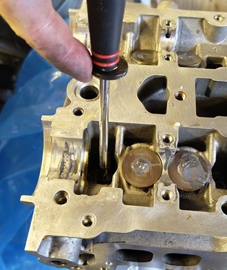

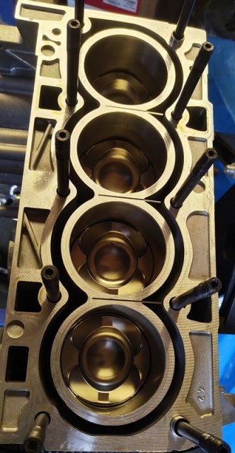

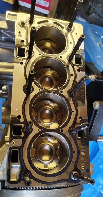

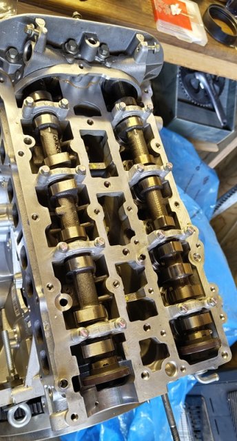

Might as well update with what happened. I forgot to put in the shims so had to take off the head again. I then found out the shims were shipped in 2 different thicknesses. The thick ones needed a little file on the edge to be slit into the block. They weren't overly tight but installed them a little below the deck surface to be sure they didn't interfere with the headgasket when mounting the head. Victor Reinz headgasket P/N: 61-10236-00

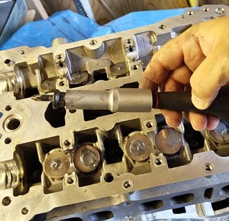

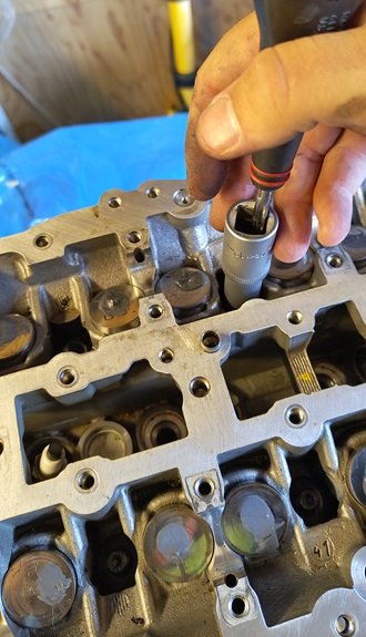

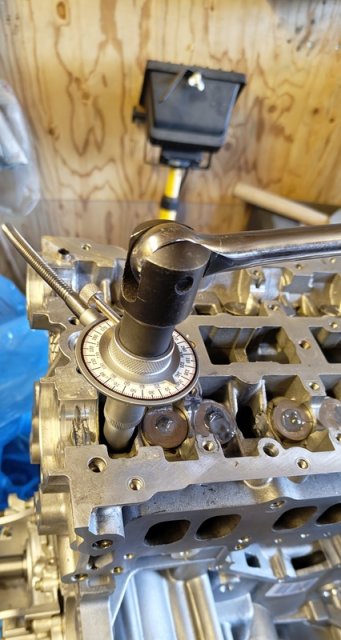

When installing headstuds I used this Philips head to put in the shims and nuts. Used a socked to start the nuts Made quick work of getting all nuts and shims in their correct places.

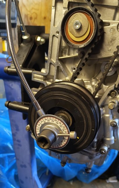

Used the factory torque specs with 90 degree turns and not the ARP specs.

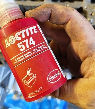

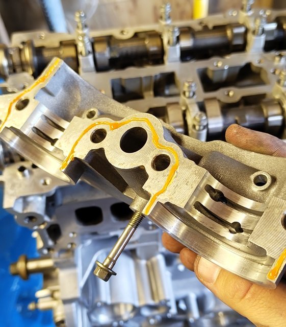

To mount the cams the end piece calls for some gasket material. I used Loctite 574 which I believe should meet WSS-M2G348-A11.

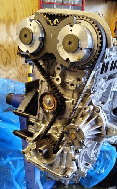

I used a brand new Continental belt. P/N: CT881. Reused the old waterpump which is in excellent knick(less than 10.000km). As well as the tensioner. No wear at all. Don't mind the butchered thread on the intake VVT cover. It tightens just perfectly, removing it is a bitch though. Tightening the balancer had me hanging off my breaker bar to get the extra 15 degrees.

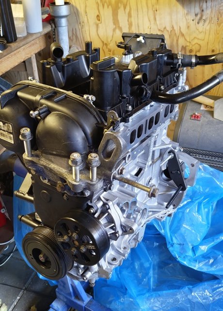

It's starting to get somewhere. Engine mount, exhaust manifold, HPFP mount, vacuum pump mount, valvecover and a PumaSpeed oversized waterpump pulley mounted. To use the oversized waterpump pulley with aircondition you need a 6 ribbed belt at 1580mm. P/N originally supplied by PumaSpeed was a Dayco 6PK1580S.
All surfaces required by the manual(HPFP mount, vacuum pump mount and corners of the valvecover gasket) has been given some Loctite 574.

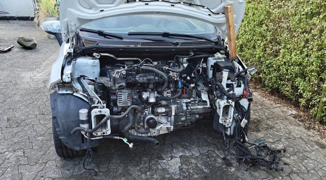

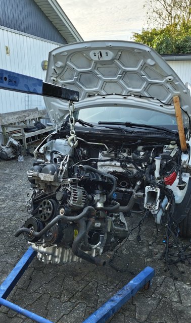

Had a few productive days with the car. Pressure washed the enginebay with some degreaser. The car is under coated in anti-rust from Dinitrol so it is still sticky in many places. Engine is in, front is still off. Electronics is connected. Found my exhaust hangers are cracked hard and need a new set. Just put a PumaSpeed radiator and OE front brake pads on order. And some Castrol 5W30(used my last 5W20 on the 1.0L EcoBoost recently. It ran 30.000km on the old oil, not optimal, but she pulled through fine). Turn of the key, on my own work, is getting closer. Cross your fingers first start isn't one big explosion.
I am very jealous of all you guys having indoor garages with smooth clean level floors. Getting the car around a sharp corner using a jack on the backend to make the turn. Damn uneven surface had the jack strand on a tiny hump. Had to push and pull a 100 turn maneuver with no power steering.

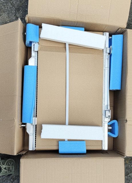

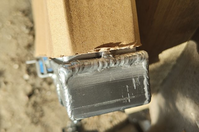

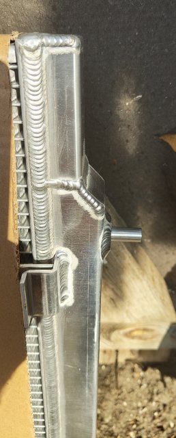

PumaSpeed radiator. Packaging was excellent. Build is good with provisions for bleedport and all you need.
It is as I like it, not pristine, but is a thick boi with performance in mind. I snapped some pictures of how it looks close up.
It's a perfect fit for me as I'm not building a pristine queen here. Down and dirty, hopefully working, fun pocket sized rocket.

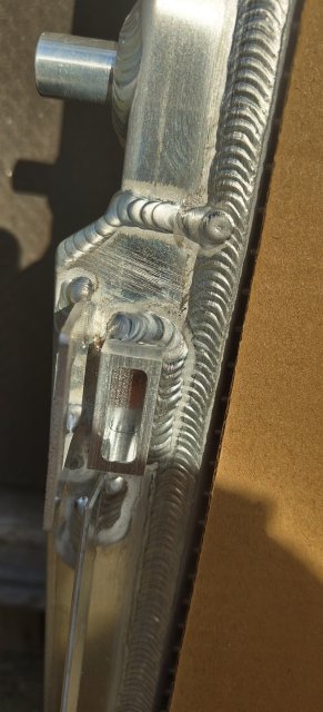

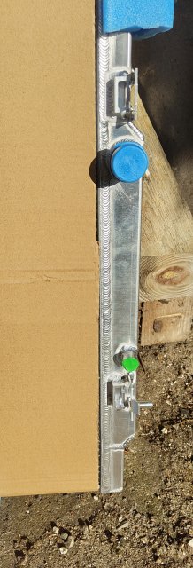

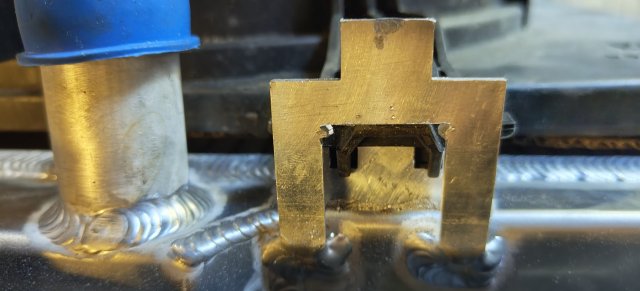

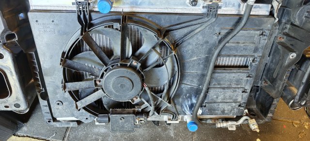

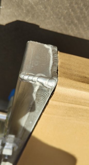

Found a few little things while mounting it. The upper left tap, for the fan, was mounted a little inwards. Nothing a little dremeling and filing couldn't solve.
The mount for the bleed valve was a little long and the stock bleed valve couldn't mount without a little filing.
The taps are metal and bendy, they will NOT last forever. So do not expect them to survive removal and remounting of the radiator forever or might I say, even 20 times.
Other than that, fit is practically stock. The A/C radiator mounted perfectly and maybe a little snug. It fit easy into the stock rubber mounts and into the front assembly.

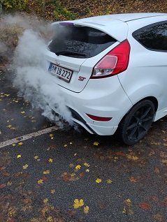

Update:
It runs. Smooth idle and revs with no hickups.

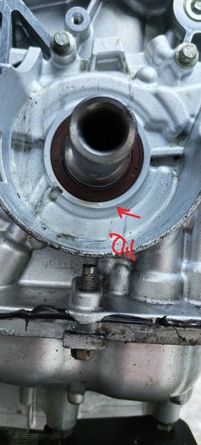

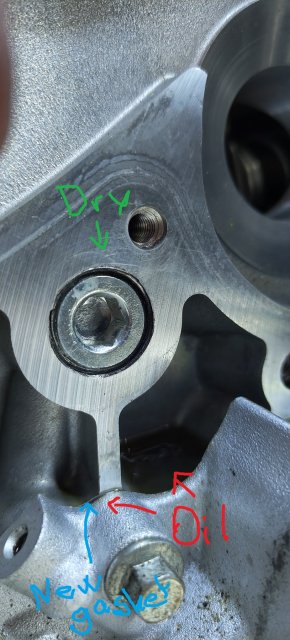

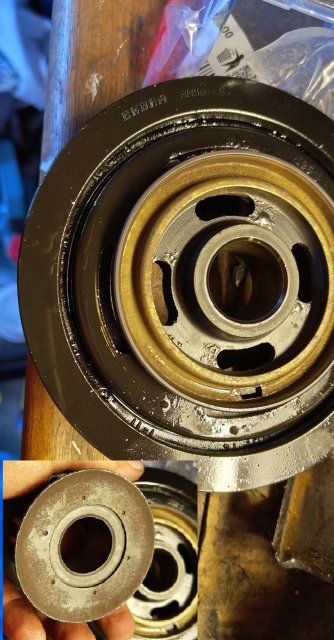

No water in the cooling system, yet. New problem arose. It gushes oil from the front main seal(my initial diagnosis). So need a little help diagnosing, if it's only the front main seal or something else as well.
I have a threaded bung in the oil galley underneath the waterpump. It has some sealant and is dry with no signs of leakage. What gets me though is the amount of oil trapped underneath it and on top of the oilpump. It was torqed to spec in the order from the manual, with a brand new gasket. Even the timing belt is dry to the touch and the VCT units don't show sign of oil in the teeth.
The front main seal is wheeping and has clear signs of leaking. Odd thing is, the sprocket is completely dry, but the pulley is soaked in oil oilpump.jpg
Have I missed something or is all this only the front main seal that is to blame? Oil pressure is good when running the engine, but it is a solid leak when it is under pressure.

I'm going to go with the gasket for the oil pump assembly is probably bad. Even if its new, it might be a dud. Also, check the mating surface on the pump/block make sure there isn't a knick or scratch

As the manual doesn't call for sealant towards the block, on the oil pump, I'd reckon it's a no go. But I will get a new gasket on order and remove the oil pump and check all the surfaces before installing it again.

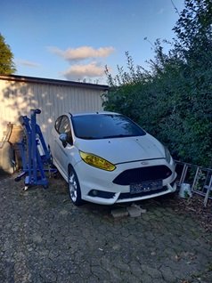

The White Wonder of the Jackstands is still around. It keeps a spot dry in the backyard waiting for me to actually put the last parts back together. Only missing accessory belt, tensioner, a fresh charge on the battery and all the brakes needs a good workaround/possibly new pads and rotors to pass inspection.
