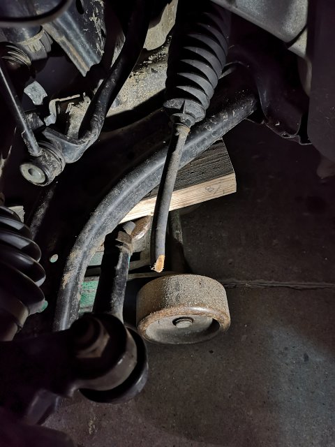

Has this happened to anyone else? My drivers side tie rod snapped while I was driving on the freeway and I lost control of the car. The car swerved to the right and then to the left into the median. This kind of mechanical failure was totally unexpected and dangerous.

I'm sorry that happened to you but it really does look like some prior damage.

From the angles you shot it at, it appears to me that the rod is bent and broke on the threads. I would expect it to break at the threads. That's common with enough force. But the bend is not. Any idea how it got bent? That bend indicates the wheel likely took a hit to the back of the wheel (3 o'clock) placing the rod in compression/tension. A hit to the front of the wheel (9 o'clock) would snap it or bend/crumble the front arm of the lower control arm. Maybe this happened to a previous owner?

No passengers and no one got hurt. Needs a new bumper, grill, broken headlight tabs, and dented intercooler. I haven't done anything to it bodywork wise yet, but it's mobile now with new Moog inner tie rod and Moog tie rod end. I did hit the other side not too long ago and bent the tie rod there. That passengers side rod was replaced. My coworker said it could be stress from that hit.

That said the bend may have happened as it was failing and splitting.

The break looks rusty: how long between the accident and the photo was taken?

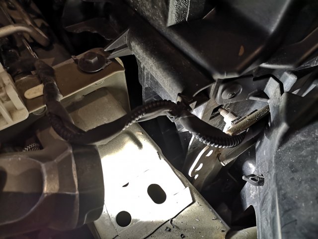

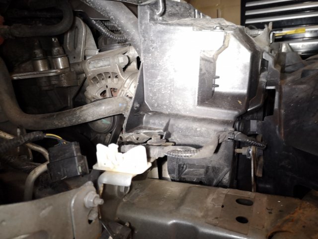

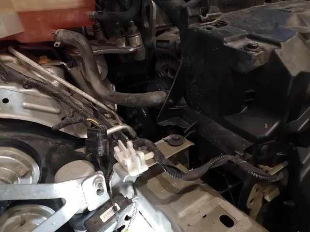

The photos were taken 3 days after the accident. It happened Sunday and it didn't get on the hoist until Wednesday. I took the bumper off and the damage is worst than I thought. The rebar is damaged and the rad support is pushed in a little. I didn't want to make a claim, but I think I might. This car starting to give me headaches now; I just went to top off my coolant and the reservoir cap broke 😤

Rad support is all plastic. It did what it was designed to do ( bust apart to deflect energy because pedestrian safety stuff) its easily replaced and re aligned. It more than likely saved the frame horns from getting bent up.
