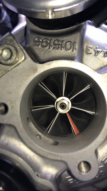

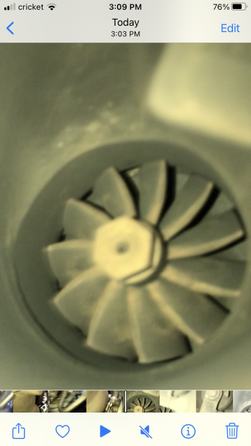

Pull off your air inlet from your turbo and your down pipe. And inspect both compressor and turbine wheels. Also confirm that your compressor wheel turns as you manually turn the turbine wheel.

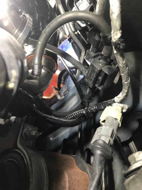

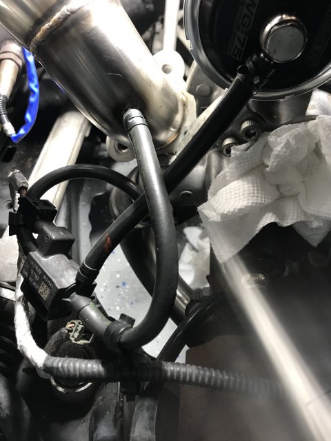

Ok I’m working on that now. How can I can I verify it’s getting oil? Can you look at the picture I posted and verify I have the boost lines installed correctly.
The way I confirm oil flow is to loosen each fitting (after wrapping them with a rag or towel) slowly and then just a turn or two. It shouldn't take much and you should get a squirt of fluid and maybe a little air.
I looked at the picture, but I couldn't tell what went where.

From the little solenoid. In the side with the electrical plug I have going to the turbo hot side j pipe. The opposite end of the solenoid I have going to the intake. The side of the solinoid I have going to the wastegate.

Can a turbo be bad with both propellers spinning freely? How can you tell if there is a problem inside of it. There is no smoke coming from the car

I read that you checked that the compressor and the turbine wheels spinning freely, but did you check that they are moving together. AKA, you can spin one and it spins the other or are they spinning independently. Also did you prime the turbo with oil by cycling but not starting the engine.
