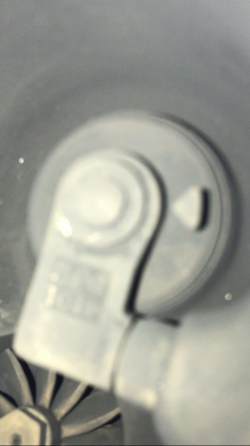

I was able to take a picture of it inside the turbo with the current preload setting.
That's what I did and that's how mine looked as far as the wastegate and preload. I listened to both the YouTube vid of the blown turbo and yours and they sounded really similar. I'm leaning towards it being blown turbo. I'm no expert though. Hopefully you'll figure it out. Sorry if it is a blown turbo. Heartbreaking.
