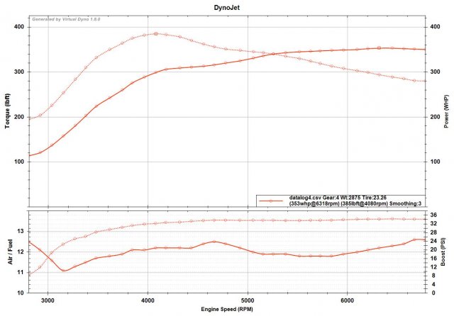

This is the First cleanish Graph I have been able to get since the aem 3.5 Bar map went in. Still not final but almost there. I have to log in 4th now as i get some wheel spin in 3rd with the R888r. This graph still seems off as this wasn't a completly level surface. Hp line dies off way to early, not sure if that's from rising charge temps or the surface but it's doesn't look right. Getting at the limit of single port aux fuel.
What is the injector size of the Stratified SPA? Thanks!

Thanks. Noticed your mention of getting near the SPA limit. I have a Whoosh SPA en-route with the larger 90 lb/hr injector (65 std) so was curious.
Not necessarily the limit of fueling. But once you get past 400whp you can start to get uneven fuel distribution from the spa.
