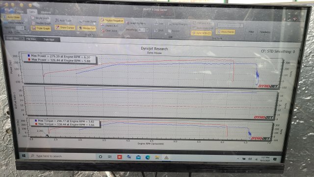

Went to a dyno with a car I installed the S280 about 2 weeks ago. I was really impressed with the numbers on Meth. (i'll try to post a graph in a while)
Pump Gas 93oct 279whp and 298wtq (he kinda floored it after 3500rpms hence the low tq)
Meth: 326whp 338wtq ( he did floor it bellow 3000 this time)
It was around 90 degrees ambient and pretty high humidity.
The car has basic bolt-ons with 3" exhaust (straight pipe), MAP intake and Whoosh V1 IC, Meth and the S280 w/ Turbosmart WG and DV+ atmospheric. Still on stock MAP sensor peeking at around 28psi and dropping down.

Those are fine numbers* don't let it get you down! All that matters is you like it!

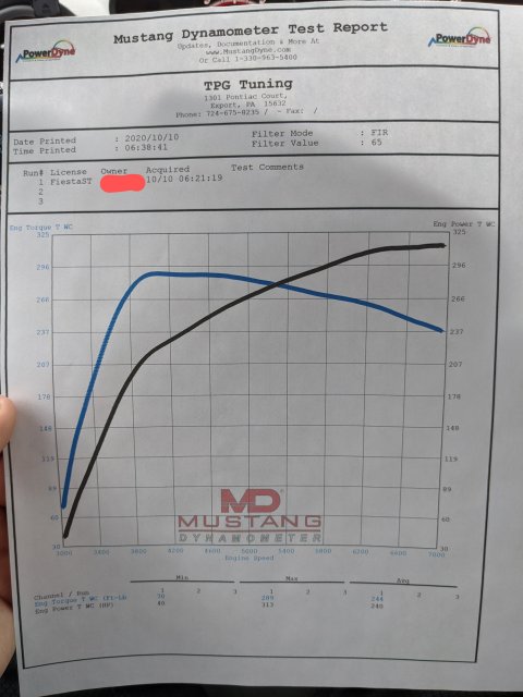

Just got my car back with S280, xtreme-di HPFP, and +30% Bosch injectors. Runs great and feels incredible, was expecting higher number on the dyno sheet though. Fuel is E-35
That's why Mustang Dyno is the heart breaker. Typically reads 12% under what a Dyno Jet reads. At least from what I've seen around this area.

Ahhh good call on the type of dyno I didn't know about that! Highest boost I saw on AP was just a hair over 27, and let me tell you this thing feels amazing. Third gear pulls snapping my head back into the seat is a ridiculous feeling in the Fiesta.

I'd be very happy with those Mustang #'s at 27 psi. What manifold are you running? Tuner? Sorry, if you have build thread I'll get it there.

I prefer mustang dyno numbers, but I'm a sandbagger.

I went to TPG tuning in Western PA, Adam Brunson does their ecoboost tuning (and a splendid job as always) I'm running the stock manifold and the Cobb Stage 3 pack (intercooler, intake, catback, and catted downpipe).
