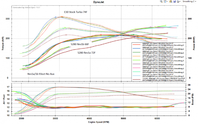

It sounds like Vdyno to the rescue. From what I can tell after fooling around with that program for a bit, if the variables are held as fixed as possible, if Vdyno doesn't measure a difference, it is probably so small as to not matter much.

Yeah, this seems to look like most of the other dynos I have seen when searching on the board. 300-ish whp on a Dynojet seems to be about where most folks end up, give or take depending on the dyno, ambient conditions, etc etc.
Considering this run was started at a little bit later of an RPM, the spool up and rise to peak torque is still occurring pretty quickly✔️

Look at that spool improvement with the WGDC✔️. This is why I used to love mechanical boost control. It was the equivalent of WGDC of 100% until the target boost was reached then it would snap open fast. It will be interesting to see if your tune eventually approaches that, I really don't know how things are handled with EBC on the fiesta.

I would imagine he's going to dial in some more fuel up top, assuming that you are not running out and the aux needs to start kicking in.....Again I am no expert on the exact needs of the 1.6, but I think that high rpm power curve can point upward a bit more with more fuel.
By chance did you log HPFP pressure on any of these runs?

Definitely needs to be 'fatter' up above 6200rpm.
Area under the curve looks good, that torque will hit hard when you find enough tire (and an LSD) to hold it).

Went to the dyno on Thursday happy with the results. E30 stock fueling.
what boost levels where you running. My Tuner was tuning mine and started getting clutch slippage above 26lbs. The things spools pretty damn quick and the car pulls all the way up to 7k I am not sure where he set the redline at because thats just were I shifted lol. I literally drop into 4th at a roll of like 50-60 and I am at 100 in a car lenght or two.
My car was also tuned on a recently recalibrated Mustang Dyno and he told if it was on a dyno jet it would be about 50-60’s hp more pretty much putting me at 265-275HP on 91. my TQ would be around 300 ft lbs
All I know is the car is fast now and gets up and walks on people. lol I have to do some data logging this week and fill her up again tomorrow. Though ya not unhappy she flies and ya I got the Jet engine whine going on.
About 26psi and tappered the boost down from 6k rpm to redline were its about 7k.

Sounds about right. I think with these turbo’s it gets sketchy on the clutch above 26psi. I am eyeballing a clutch probably in the spring and will do a LSD install at the same time. Then maybe screw the boost up a couple more lbs:ROFLMAO:
