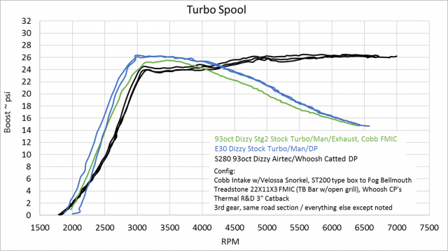

Thanks to Jason and those who blazed the trail... 300+ WHP after only 3 maps!
Tuning progress: Dizzy Rev1c (base + 2 revs)
1st Rev with Whoosh SPA on
Tamb=52F, 14.5 psia
32.5 lb/min @ 26 psig @ 40% TS14 WGDC
Spool within 200 RPM Stock Turbo/CobbIC 93oct, within 300 RPM E30 SameIC(280 E30 after 93)

Looking more closely at those boost curves....This S280 definitely looks like the winner for best street/stock like spool turbo. There appears to be literally almost no disadvantage over stock. The tiny difference below 3000 RPM is insignificant and would never even come into play during any sort of spirited driving.

Not sure its quite superbike performance (as its likely an S280 car in great tune is probably going to trap <120) but we get your point😁
The dyno charts I have seen have clearly shown that this turbo has much more top end then the other similarly spooling options, and the peak power isnt all that far off some of the tamer Garrett options it seems.

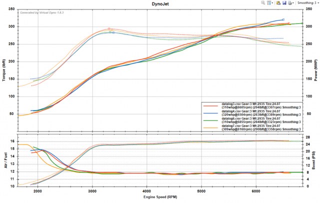

Tamb=52F, 14.5 psia
Is this on stock fuel and E30 tune?

There are a lot of acronyms used for different things with the FiST (and theres one of them!) and in the post above where it says "whoosh SPA", that means the whoosh single port auxiliary fuel system.
