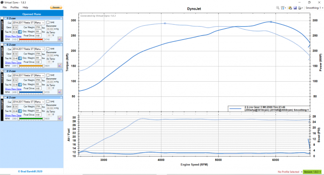

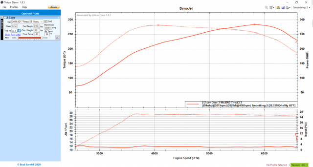

Ok Shouldbeasy added a few more bits of info into the program to get a more accurate read. I should add he hardly had to add any smoothing. This graph speaks leaps and bounds about Adam at Tuneplus‘s tuning . This is the 2nd revision off of a Base tune and this is 91 octane pump gas 284HP 282TQ on pump gas! Tuneplus FTW!

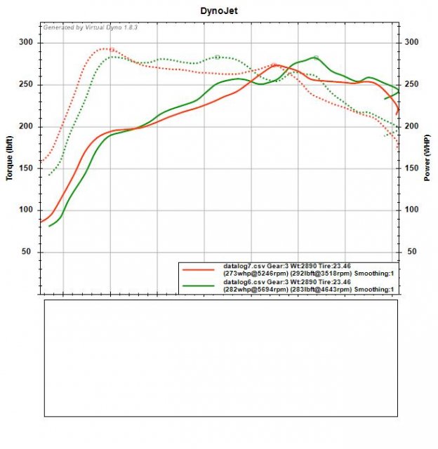

haven't played much with the program yet but here's my 91 2nd rev from Tune+
next up is to see where fuel takes us, maybe suck it up and go 93 and then think about how bad i want a big fuel pump and aux port lol Fiesta ST S280 Tune+ VB.jpg
6,370
6,008
next up is to see where fuel takes us, maybe suck it up and go 93 and then think about how bad i want a big fuel pump and aux port lol View attachment 39203
Your TQ is falling into about where It should be,what temp outside ?
You should be seeing about 10 more HP did you apply any smoothing to the graph. I know my graph did not get much smoothing. Also what are your tires? Are you getting tire spin? That will totally mess up your chart readout.

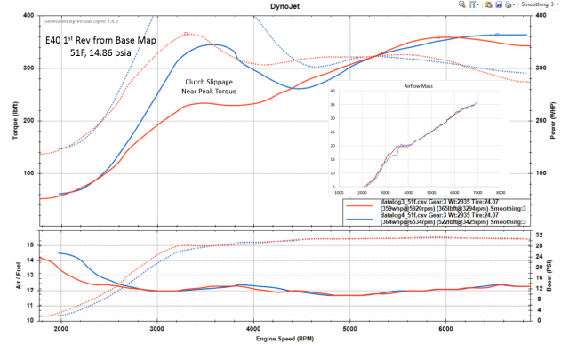

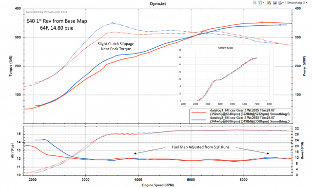

Haven't posted since final 93oct tune in December. Here's some E40 results:
Tuning progress: Dizzy Rev2B (Rev2A base + 1 rev)
Tamb=51F & 64F, 14.8 psia
36 & 35 lb/min @ 31 psig @ 56% TS14 WGDC
I'm getting some clutch slippage near peak torque since going to E40, more times than not. LSD additional tax on stock clutch (car only 5k miles). Most times not noticeable until loading into Vdyno.
I grabbed some logs early in am, checked AFR, tweaked the fuel map, then grabbed a few more, so 2 different Tamb & Pamb, noticeable. AFR dialed in after 3 iterations (1st not shown, 12.7 up top).
99
97
Greenville
So pushing above 300wtq is straining the clutch?
Fair question. 1st, I can't be certain between clutch slippage or tire spin. The 1st time it happened it was 32F with Federal SS595's, it felt like tire spin to me. Most times, it's completely unnoticeable. I inquired with Jason as I know he had clutch slippage once he started to push the 280. His feedback was clutch likely.
I think there's more at play than a simple torque threshold. Rate of change, and how the peak is held are probably in play.
I probably should have labeled clutch or tire spin. I am going to see if I can get some 4th gear pulls to see if that helps understanding.
