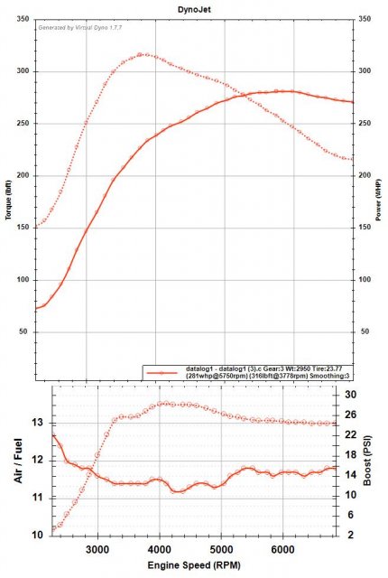

Looks like we're going to be turning on aux fuel for my 93 tune till I tune with ethanol in the spring. I'll try to get a vdyno when it's done although the cold may make it hard but I will post a log once the tune is finished.
145
59
SANTEE
This is my final revision before activating PI to my 93 tune. This is about what you can expect with no additional fueling on 93.
Hell yeah man! I finally started tuning again. There was an issue with the supplied gate. It was opening under 1psi lol. That was why I couldn't make boost.
