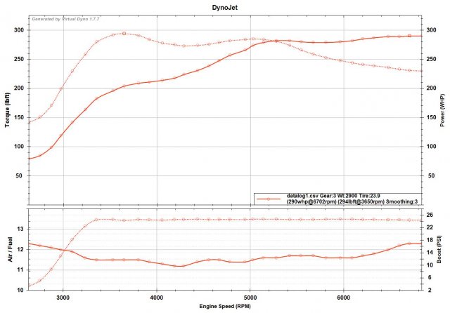

Here is my 6th revision. tuner says were finishing up but im going to ask him to push it further and utilize the aux up top to get the most out of 93 octane. aiming for possibly 27-28 psi but we will see.
https://datazap.me/u/westley-roy/s280-revision-6?log=0&data=4-5-8

This is WITH aux fuel? Why is it leaning up up top?
We haven't adjusted my aux fuel tables since I was on my hybrid so idk how it's functioning right now.
I don’t understand. Why wouldn’t you adjust the aux fuel tables? Who is your tuner again?
The aux fuel uses a separate controller and uses map voltage to adjust for fueling. So up to this point it hasent mattered but we're gonna have to adjust it now.

What kind of boost were ya'll making on the base map because it kind of sounds like I have a boost leak
It's ussually just wastegate pressure. The spool of this turbo sounds very different then a stock or hybrid turbo.
base map with supplied WGA is going to be 5-7psi
as long as the base map is 0 WGDC % which most are
