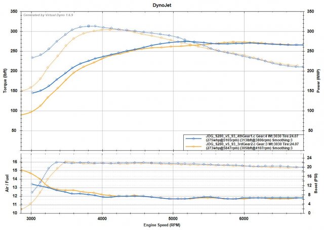

Just about out of fuel at 275WHP/300WTQ on Virtual Dyno. Still on 93 without aux fuel. These logs were at 24F ambient temps which is why I think the spool is so fast.
Woods247
2,682
4,894
Atl
Admittedly, I haven’t read through this entire thread because it lost me more than a few times. Is this turbo less powerful than a Whoosh or Pumaspeed hybrid? I’m a little confused because I thought this was a +350whp capable turbo with aux.
Everyone here is still tuning on 93. On aux and ethanol it should make 350+
I edited my post since it was a bit confusing when I reread it. I have aux fuel installed but am not using it yet. Tuner wanted to get to the point that it was absolutely needed before starting to tune with it. I am there now at 275WHP/300WTQ on 93 and will be tuning 93/aux fuel next.
It should be more powerful than a whoosh hybrid and X47R or X57 turbo. It will likely be inline with what I am seeing with the Pumaspeed X57RS turbo.
