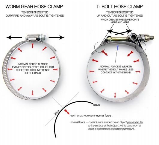

Another thing I cant stress more....buying the extra clamp kit for all boost hoses from Ron at whoosh to double up....I did it and it helped with blowing hoses off!
https://whoosh-motorsports.myshopif...it-for-intercooler-boost-hoses-fiesta-st-2014
These constant tension clamps are another option to consider.The t-bolt clamp on hot side charge pipe on turbo coupler had a tendency to come off pushing 27psi with my X-47R,but replaced it with a constant tension clamp and 9,000 miles of driving with it never coming off again.
https://www.turbosmart.com/product/murray-clamp-constant-tension-clamps-2-750-3-625/
How is that better than a Tbolt? Is it comparable to a jubilee clamp?

Well, it was a leak
I had a total of 3 leaks thru out the charge air system
1) one at 5 psi at the coupler of the cold charge pipe and the throttle body, this one was a very tiny one
2) one at 15psi at the coupler of the cold charge pipe and the intercooler (this was the annoying one that sounded like a teapot)
3) and another one at like 22 psi at the coupler of the hot side pipe and the intercooler (this one was massive, it lost all boost when it reached that psi) didn't make any hard sounds
All 3 of these leaks had t bolt clamps on them and they still leak.
replace the t-bolt clamps and double t-bolt clamps on the later 2 leaks
