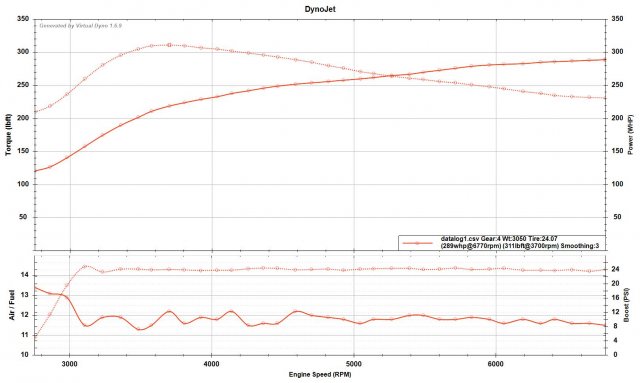

Heres a pair of 4th gear pulls from my 93/aux latest revision. Lbs/min is the same as my c39 was on aux/e50. Still needs some tweaks as I was getting some knock in the warmer weather today.
What lbs/min are you flowing on these logs? Curious how much farther I have to go on 93/aux (I'm flowing 31 lbs/min at redline).
You guys running the stock heat shield or did you leave it off?
32.5-33 and I don't have the heatshield anymore.

guess this on whoosh page is misleading!!
*315whp / 316wtq using 93 octane @ 28psi is a dyno proven result with the S280
No just every car is different and all theses graphs are vdynos. Even real dynos vary depending on the correction factor and the type of dyno.
