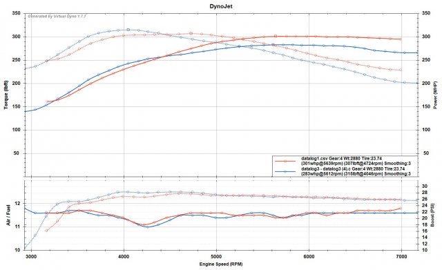

Heres a pair of 4th gear pulls from my 93/aux latest revision. Lbs/min is the same as my c39 was on aux/e50. Still needs some tweaks as I was getting some knock in the warmer weather today.
Can you get it on a real dyno easily?
