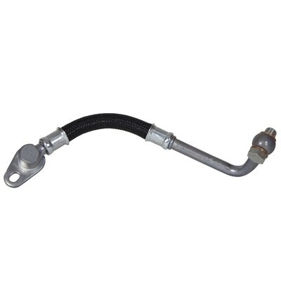

I am very grateful for such valuable information, you have definitely helped me a lot, I comment, notice that the S280 kit I have acquired used with little mileage (2000 miles approx), I still do not install it precisely because I needed information like this to start and not all are open to provide it, I don't know if the fact that it is used makes any difference when it comes to the oil, I mean that I just did the oil change less than 1000 miles ago, it will always be necessary to do the oil change when install it ???
and re regarding the oil feed pipe I am going to place an image to corroborate if this part the one that I should change
part number is BM5Z-6K679-A
