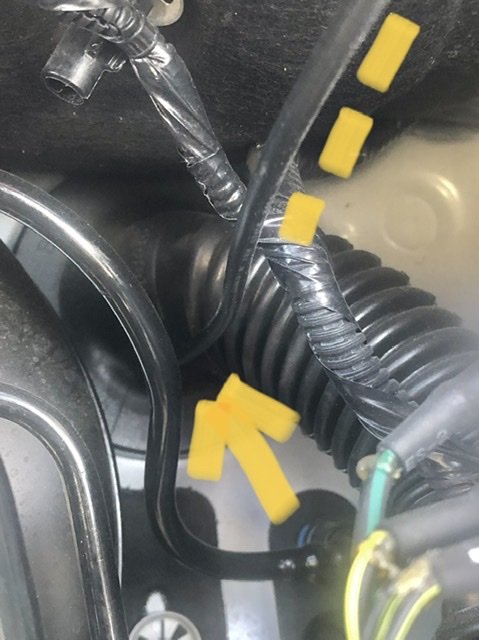

There’s a rubber diaphragm that’s sort of a firewall pass through for the symposer tube... I stuck an awl through the bottom of it, and some wires for the Ethanol sensor system. Worked out well... wire came through right at the edge of some thick insulation on the inside, and the rubber diaphragm sealed nicely around the wire.

No, the firewall pass through for the tube. let me see if I can show you...
Hmm. That cable or wire that you are following up top, with the yellow marks, that is not the symposer tube though. But you just punched through main rubber grommet that the large wire bundle goes through?
420
325
Phoenix, AZ, USA
Symposer tube is in the middle of that. The yellow marks follow the wire I installed.

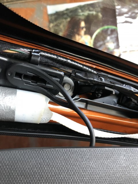

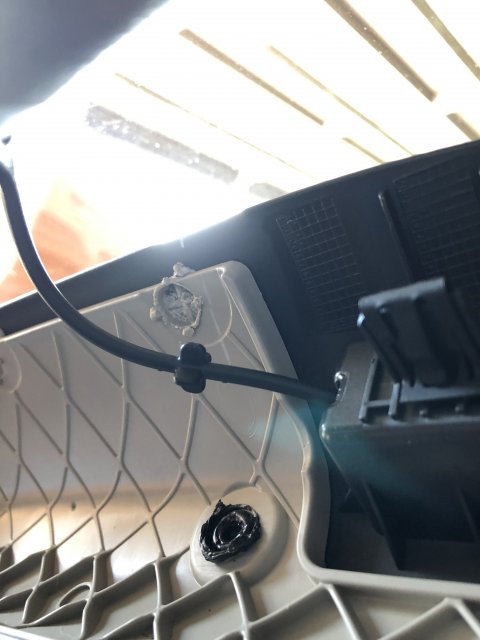

I got tired of messing with that damn symposer tube so I opted for another location. Running wires in the fiesta isn’t the easiest. Even getting the main plug for the back of the gauge up to the a pillar area was a pain.
On that note, what’s with the “leashes” on the a-pillar trim? I’m guessing it’s for if the airbag goes off it prevents it from flying? Since I didn’t feel like messing with that either I just cut those damn things. So it’ll probably impale me in the case of side airbag deployment.

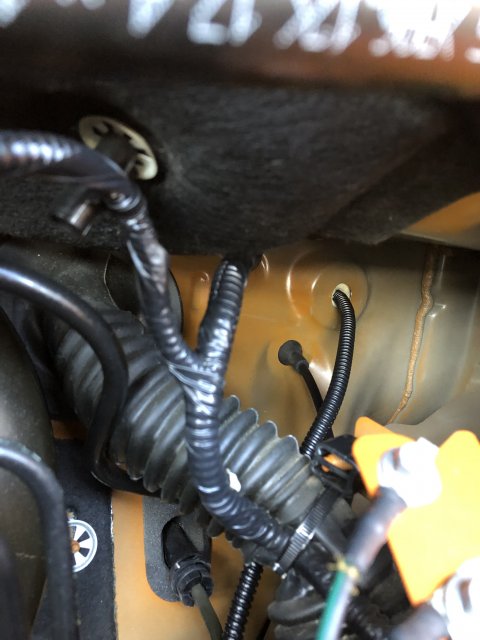

Yeah I mean even poking a pick through the existing hole and through the sound / heat deadner and I was quite close to poking it into the huge harness on the other side. It’s not just drilling it everything is so tight in these cars.
