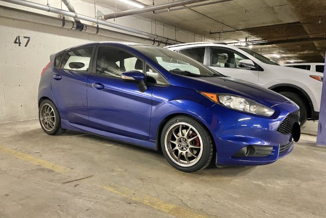

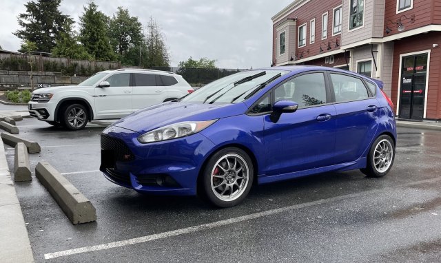

FWIW, are how 16" J10s look with RE71RS in 215/45 and 205/45 on -1" coils (B14s) and no spacers. I decided to downsize because I found that, during autocross, 215s rubbed the fender metal at the top of the arch. For disclaimer, multiple people have told me that they run similar setup without rubbing and supposedly B14s have same bump stop height and all but overall I'm convinced that 205s are the widest safe width we can go with for performance driving (too bad, because meaty 215s look good and since REs have wide shoulders they make the rears look less "tucked in")
Also FWIW, J10s come in 17" as well so if you like the look but want more rim surface area, that's possible.
