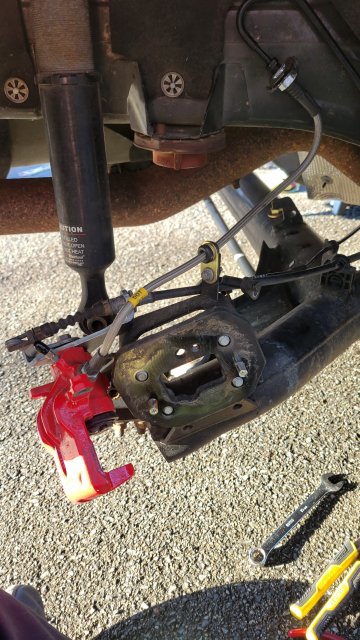

Update on the brakes.
I rebled everything and it's definitely the PR caliper. I have great flow all the way through the hard line and the SS line but still almost nothing from the caliper. It's got enough brakes to drive normally so I'm just waiting on the new caliper now.

Score! Got the new caliper installed, very very easy BTW, only a couple tools needed, 8mm socket on 1/4" rachet, 13mm socket, 14mm wrench, 11mm wrench, some large adjustable pliers, and a big flat blade screwdriver.
Got the Russell speed bleeders installed and they definitely make things even easier.

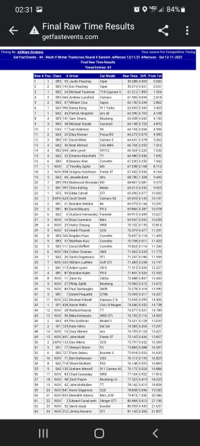

Forgot to upload the times from the last track day. I started running into brake fade in the 3rd PM run and decided to back it off a hair.
I have XP10 and 8 pads on the way to remedy that.
Edit: apparently using mobile completely nerfs the s reenahot of the times so I'm gonna try to use my computer and see if that's better.

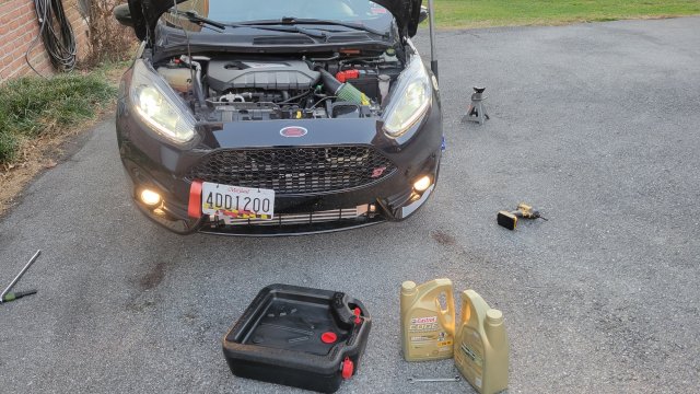

Got the Dpro camber plates in, Carbotech XP10/8 pads installed, coils cleaned and adjusted.
Went to change the oil and got a surprise. Found a keeper on the drain plug. So now I've started pulling the VC, hopefully have the c a s fully exposed tomorrow, then get the engine in time, belt and pullies marked cause the cams have to come out, then the fun job of finding what cylinder it's from.
Hopefully I can have it fixed by next track day, on Jan 8th.
While it is apart I'm obviously going to check all 16 valves to make sure the keepers are set in place.its been 4k miles since the last oil change, 2 track days, and obviously I have no idea how long it's been fucked up. Car still runs and drives perfectly fine, so I'm very grateful that I was able to catch it now.

This has been encountered before by another member. It was left/ lost accidentally during install of engine by fomoco. Not even worth pulling the VC. Think about it for a second....if that keeper was really "Gone/missing" that engine would have some major issues. Just an FYI...
Not the first I've heard of an extra keeper, but I am not going to take a chance, plus just found the back, exhaust side, of the VC is leaking, so I gotta get a gasket and remedy that.

Just read the other thread about this issue from earlier this year.
Think I'm just gonna do the VC gasket and cam follower and not pull the cams.
My keeper is also in perfect condition, and I just started doing track stuff 2 months ago, so it's well within reason it's been in the pan the whole time.
If it blows up, then hopefully it'll be on video.

New VC gasket is in, woot woot for parts at cost with no shipping, perk of working at a dealer. Gotta find the new cam bucket I bought eons ago.
Plan to have it all back together, and not leaking, on Friday. Still need to bed in the new Carbotech XP10/8 pads for the 8th.
