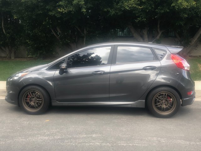

just got the miester gt1s installed and can confirm drop is really mild. closer to half an inch and not likely more than an inch. car still looks like a crossover. I did request the shop increase ride height to be as high as possible without impairing performance with street and track driving.
I also screwed up and forgot to bring in a set of taller springs with higher spring rates, so guessing I could increase ride height further.
Can the GT1s piston travel and valving actually handle any taller springs than what they spec?
That's not bad at all, but that is the very highest they will go and be functional on their supplied springs, correct?
Yes this was the tallest setting recommended by a more reputable suspension shop. I took a test drive around the canyon roads and they rode well enough, even if a tad too soft for my preference as I suspected. Will try to take it for a more comprehensive test drive at a track event this weekend and see how it holds up.
With the springs, I believe so, but going to double check. The range of springs offered are 180mm to 200mm from Meister but sourced from Swift. I actually have 200mm Swift springs on hand but they just aren't installed yet.
