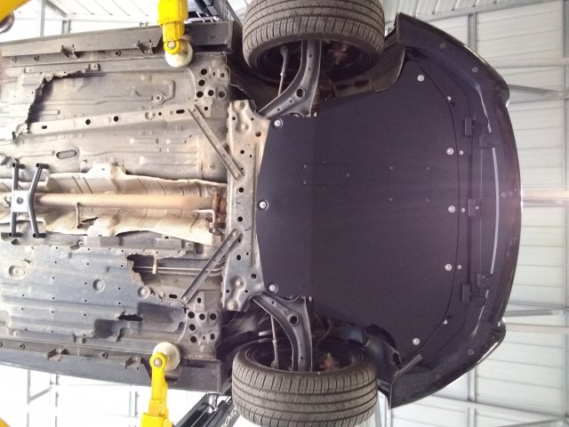

Here's a picture of my car in the air, in case anyone wants to know what the ADF skid plate looks like from the bottom. It has removable panels for changing the oil which work perfectly. I'd be interested to see what the skid plate guys plate looks like from the bottom if anyone has pictures
There are no oil change hatches on the SPG's plate, so it has to come off for oil/gearbox fluid changes. [:(]
But those would be rendered useless anyway if they took a direct hit on rough stage roads, so I do not mind.
The car has to be raised to do changes anyway, and it takes an extra 5 minutes to remove, as the time consuming part is installing the brackets during initial install, and they stay on the car even with the plate removed. [wink]
But it does have two vents for under hood heat, or water from monsoons/deep puddles to escape, formed into it.
