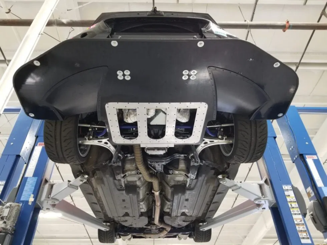

These are the splitter diffusers I was referring too. I’d like to build my own but their price is reasonable.

I also think the Pierce bar hangs way to low. My car is at a very conservative height and I smack the bar on everything/ I may consider fabing up something custom.
I'm excited to see your aero package. These guys make some cool aero accessories I think you'd be interested in https://professionalawesome.com/product-category/aerodynamics/

Yeah those guys are indeed Awesome. I plan to use or copy their $150 splitter diffusers. I like their splitter rods too but for now I just plan to use what I have since time is running out .
