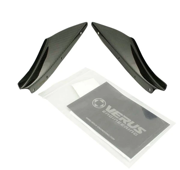

Not sure where Woods got his, but there are these from Ron (Whoosh Motorsports);
They are called canards, or dive planes, BTW.
