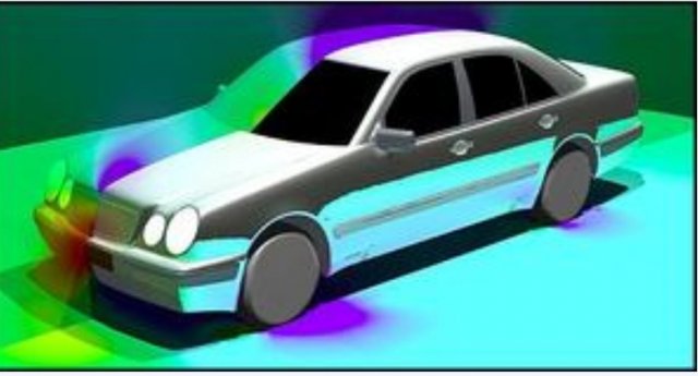

Another picture from Ecomodder.
Note the low pressure zones, this is why I mentioned the front wheels being a good option to ventilate hot air.
There is a light blue section on the hood too, before the high pressure zone of the cowling that these vents are 'trying' to take advantage of.
Its also my understanding that the front lip on the hood vents (specifically the WRC spec ones) creates a kick up for the air and thus a low pressure zone immediately after (which is where the opening to the engine bay is). So, I'm hoping that the contoured shape of the CMComposite Hood Vents also achieves this effect.

Ok, I see.
No doubt that Ford and M Sport are smarter than us, I'm sure they serve the purpose that they intended.
Sometimes we get stuck searching for the perfect method, when a perfectly functional method is right in front of us.
That being said, the beauty of a sealed system is reduced drag and less wasted hp trying to cool it, thus the search for a low pressure zone to optimize.
Also, I believe adding hot air to a low pressure zone will further reduce drag.

Yes, I do not believe that they were going for any real aero/anti-lift/downforce at all with those, but purely heat extraction.
Given the very short front clip we have on these (and most of the other rides used for rallying), and the big intake ducting system they use on the WRC cars, the 'usual' huge, near the leading edge of the hood, reverse facing scoop type, aero vent is an impossibility for the WRC cars, and even ours. [:(]

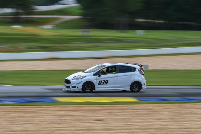

One single “action” pic from 2 days of driving lol. I always forget to ask for pics nowadays. My boy Adrienne caught a bad ass shot though didn’t he?! Whatever he does to blur the background is cool.
409
273
Jacksonville
last time I was at this corner I saw two ferrari challenge cars with brake rotors glowing spin eachother out, then the F1 car left on a wrecker. I think the fiesta looks better out there anyway

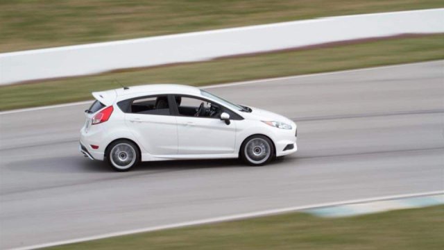

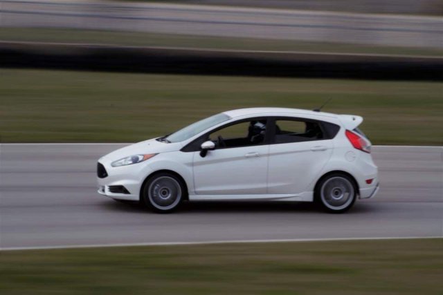

Same with my friend, overcast day made it look like poop thought. These are some old shots before the bbk
14,849
7,311
I keep hearing from people that these are not the 'most sleek', or 'best looking cars out there', but as far as 4 door hatches go, they ARE about the best looking ones I've ever seen (especially yours in those pics above). [wink] [thumb]
