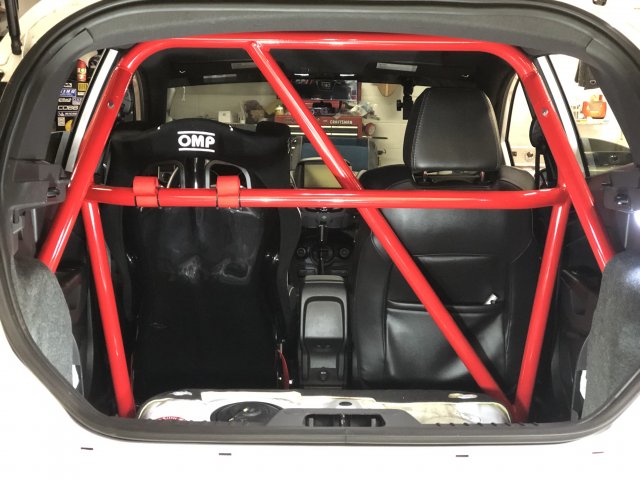

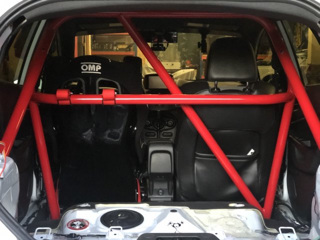

More progress but it’s still not finished. The reinforcement plates are welded and painted, the roll bat is installed and bolted in, the carpet is cut and back in place, the eye bolts for the harness are mounted to the floor with 1/8” plates installed underneath and the seat spacers are finished. I need four longer bolts to bolt the seat to the Planted bracket. I’ll pick them up tomorrow.. Once I have them, I can install the OMP seat, Bridgemoto 6-point harness and the console. The rest of the interior will have to wait until next week. This is no quick job by any means. Everything associated with the roll bar and harness has been reinforced to meet or exceed any sanctions I decide to compete with. Here’s a few pics:

All I can say is wow!
