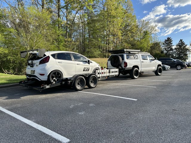

(y) Interesting optical illusion! Wide-angle lens distorts relative size difference between FiST and Tundra.
that is not an illusion. the BrokeFiST has eaten many a track car. it has grown substantially because of it. BrokeFiST and our FiSTs are not the same. I'm not even sure why @Woods247 has it rigged up this way. last i checked the BrokeFiST tows the Tundra home before tucking it into bed at night and then working a 12hr swing shift at the factory.

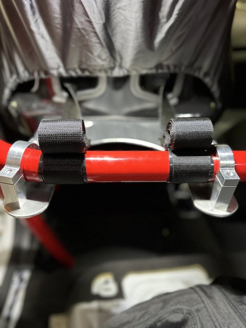

…I also forgot to mention that my seat is connected to the rollbar now which resulted in a MUCH stiffer ride on the street. There’s zero flex in the seat now.

Racetech seat? They are the only current company I know that attaches their seatbacks to the roll structure. Its a fantastic idea. I have one of those for my other race car. It was developed by Racetech for the Viper Race program. They were designed to take a 45g hit and with the slots for a proper 6pt harness. This is the only 1999 FIA seat with these features. It wasn't until the 2009 standard that these features started showing up.

Kirkey seats attach to the harness bar too but I prefer composite over aluminum construction.
