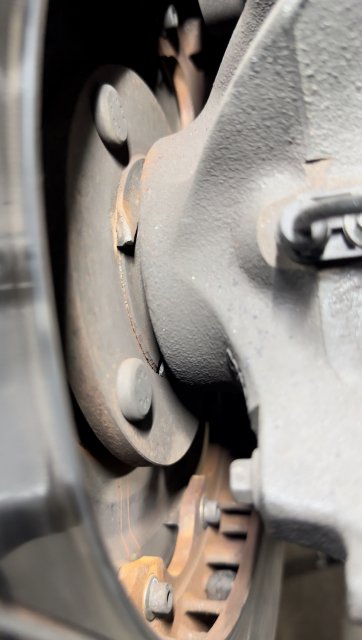

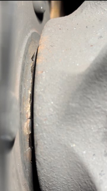

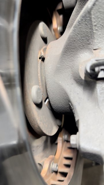

Ooof. Maybe coulda died yesterday??? Front hub cracked. I thought a tire exploded at 130mph but it was a hub coming apart. 😬 Changing all four every year now 😂
14,906
7,354
Yikes! I guess your hubs see more abuse than the average fiesta owner, I don’t think I’ve ever heard of that happening
Some of the ARA rallyists' hubs probably see similar stresses (and even more impact type stresses than hopping the curbs on road courses) albeit not the sticky tire/aero induced side loading g's of Woods247's ride.
But, even if they do every event available to them in the whole country, they are not competing as often as Woods247's car sees the track. [wink]

Why so often? Is it because you race yours?
It sees a lot of track time. I also run wider 235 tires and have about 100whp over stock. The hubs weren’t designed for the way I use the car so I will need to replace them more frequently. I’m sure I’m not the only one to crack a hub but it definitely isn’t common.
