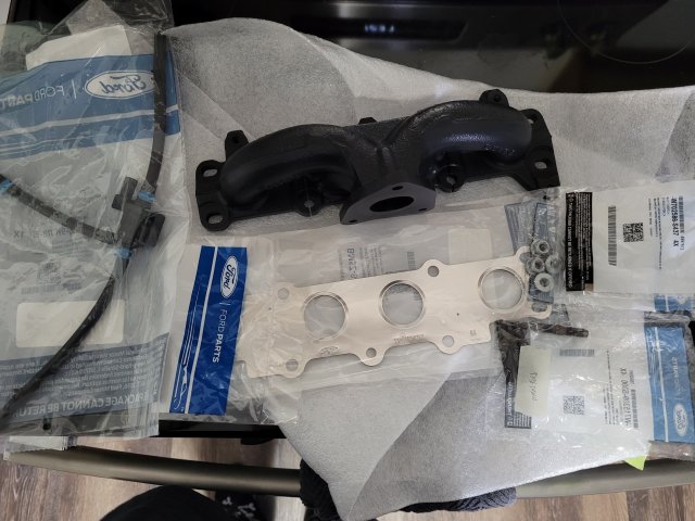

picked up a whoosh hybrid track spec turbo, ported oem manifold (probably wont have in hand till Oct), manifold gasket, 2x ARP downpipe studs for turbo to mani and turbo to DP, oil feed line.
I'll grab a milltek catted DP and Tune+ wastegate before the install. Curious which spacer for the O2 sensor? There is a J shaped and a straight one. How did you choose which one?

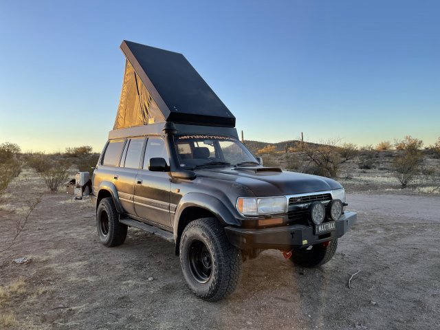

We just recently sold our 1991 HDJ81 RHD Turbo-Diesel. Wonderful vehicle to drive(especially with the Scheel-Mann Seats)! It even got a crazy rare pop-top installed just a few months before it sold! :cool:
If you actually do buy an RHD 80-Series, be prepared for parts that are no longer available! We struggled to find parts for ours!

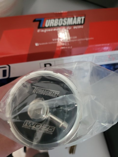

Tune+ wastegate. Minus the Tune+ logo I guess.

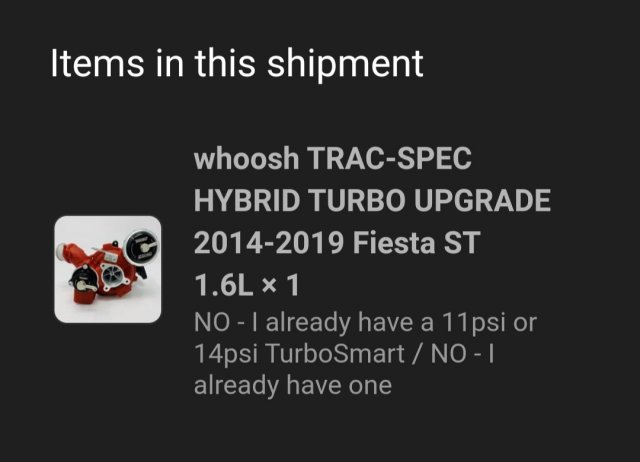

Parts have been filtering in for the hybrid turbo (minus the turbo yet)
The Cobb carbon fiber intake is here. I want to install this weekend, the instructions are a bit confusing on their website. I have a 14/15 evap harness and not sure whether to swap it out or not, Cobb states the intake will work with either one. I'm thinking the 14/15 will at the least have less of that tubing and check valve from Cobb not used.

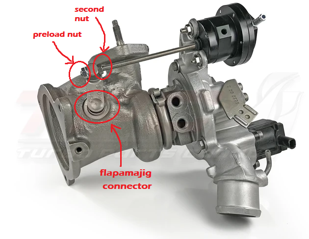

After reading tons of threads on wastegate preload, watching Dizzy and tune plus videos on it...I'm still lost. For fiesta hybrid it's recommended 4mm preload.
Is that 4mm from the tip of the arm to the back of that first nut?
Even after watching the videos the process is never actually seen. I feel like this is pretty simple but perhaps difficult to explain? The good news is I'll be able to install and set preload with the turbo on my bench.
Step 1-Push wastegate to full closed position
No clue actually what to do next. Will help to have turbo in front of me.

As I have understood it preload is 1mm per full rotation of the nut.
When setting it the preload nut should be tightened to just close the bypass flapamajig. When it's fully closed and no loose movement(by this I mean it shouldn't open without moving the wastegate rod) in the bypass flapamajig that is 0mm of preload.
EDIT: To clarify you should have 2 nuts on the wastegate rod. One in front and one behind the flapamajig connector thing. The second nut should never touch the flapamajig connector when setting the preload. So set it as far back so it doesn't touch. When preload is set the second nut should be tightened against the flapamajig connector.

This actually puts it into a perspective I can speak to. Once fully closed the preload nut would then need (4) full turns to reach the recommended (4mm) preload. I think I got this. The visual made more clear. Thank you.
