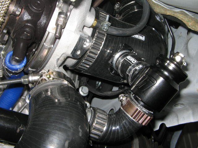

Another thing I decided to do was change the style of compressor housing used on the 6258. BW now make a housing that deletes the diverting valve and the machined port in the housing. This machine port causes the turbo to make a very unusual noise when it is producing boost underload. This only happens at 20psi and above. I would describe the noise as a ringing sound and it quite disconcerting and loud. You do get use to it.

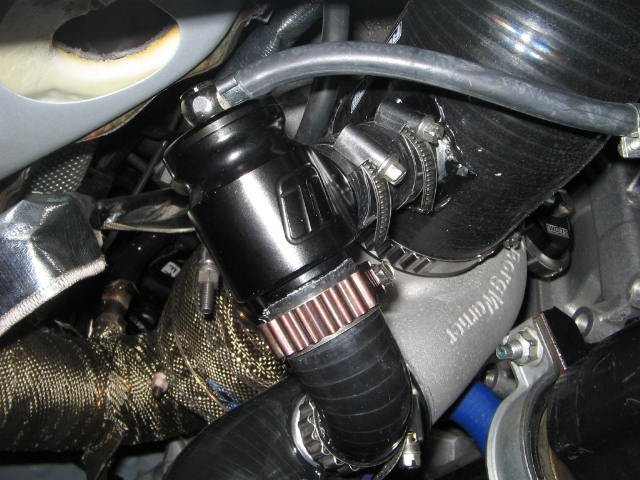

Changing the housing also meant running an external diverter/plumb back valve, see pic.
This is about the best image I can get, getting the DV in there was a squeeze for room. The DV is mounted between the compressor inlet and outlet hoses.
