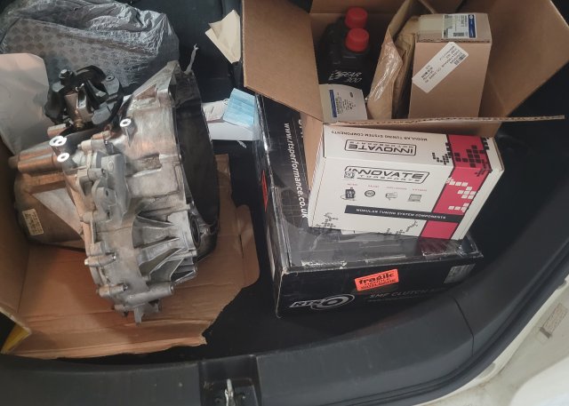

Scheduled for install at the end of this month: Trans with Quaife installed already, RTS dual friction clutch, and 4.3 final drive gear. Also have a new slave cylinder, new fluid, and the bearings/bolts for 4.3 gear.

Car is in the shop for the next few days. Final drive, refreshed trans with Quaife LSD, RTS twin friction clutch, new slave and a bunch of new bearings, as well as an ethanol gauge. I don't trust myself with clutch/gear work so I'll pay for that. Once the car is back then injectors/hpfp and a bunch of interior/exterior stuff.

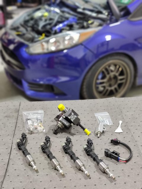

Thread Starter #216
