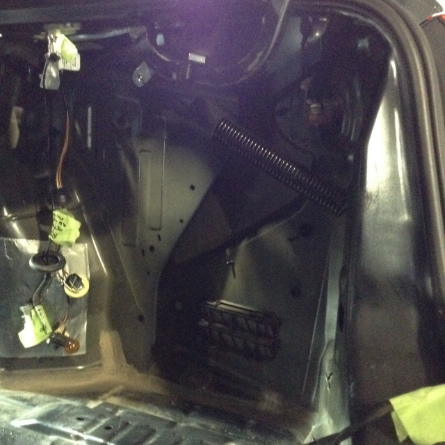

Rear trunk/boot area is going to require extension of the 19 ST tail lamp wiring harness as well as routing the back up light into the lid. Then there is the rear camera, latch, pressure switch, tag bulbs and trunk lamp harness to contend with. 1649850587536.png

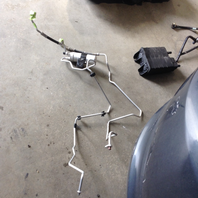

Next snafu: The ac line from the condenser to the evaporator is different between the 11 sedan and the 19 ST. The sedan has the receiver/drier on the side of the condenser and the fitting is different. The ST receiver/drier is in the ac line bolted to the rf frame rail. I don't want to buy a new condenser so I am going to take apart both ac lines at the condenser end and combine them. I have no idea if having two receiver/driers in the ac line will affect it. 1649881255398.png

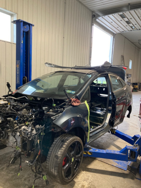

Learn from my mistakes. Don't drop out the entire drivetrain with struts, axles, brakes, wheels and the subframe attached. It fought me the whole way back in. It was like trying to get a really huge helpless chick off the floor of the bar when she is totally shitfaced then get her out the door and into your small car. There was a lot of sweating and cursing and its just not worth the effort. ;) 1649891965638.png

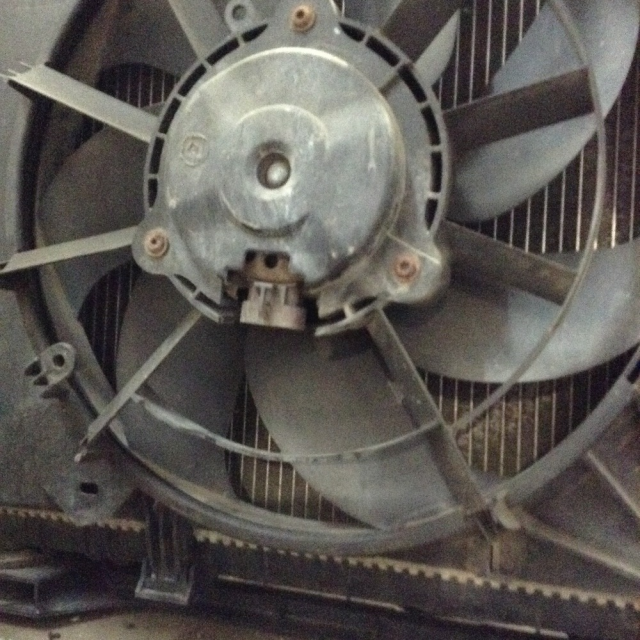

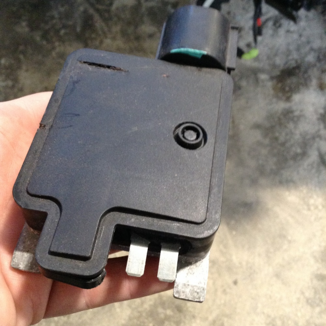

The cooling fans are different. The 11 sedan has a conventional fan activated by a relay. The 19 ST has a cooling fan with a PWM speed controller. This fan is variable speed based on inputs by the PCM. The controller and fan on the 19 were crushed so I will be changing that out. 1649950420066.png 1649950438956.png

The cooling fans are different. The 11 sedan has a conventional fan activated by a relay. The 19 ST has a cooling fan with a PWM speed controller. This fan is variable speed based on inputs by the PCM. The controller and fan on the 19 were crushed so I will be changing that out. View attachment 48181 View attachment 48182
Ordered a new fan and shroud. Should be ST specific since I gave them the vin for the ST.
