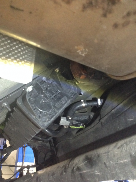

Not a sexy picture but this is the custom bracket I made to fit the 19 ST evap canister onto the 11 sedan. Also in the picture is where I eliminated the hard plastic line by using 14mm ID silicone vacuum tubing and crimp clamps. I'm still waiting on my 12mm tubing to the other line. 1650281697081.png

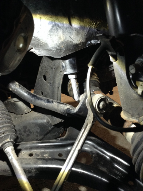

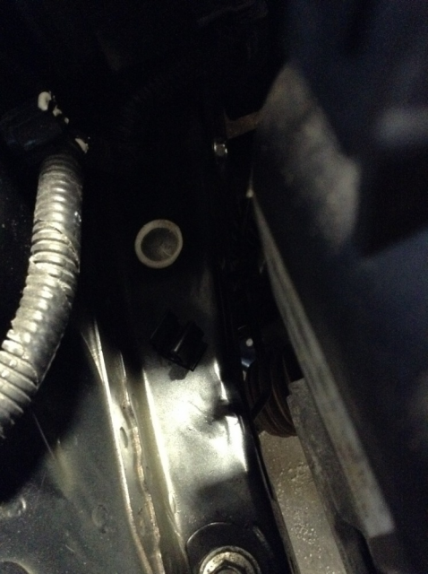

So when I tried to take out the subframe bolt, the captive nut inside the frame broke loose and just spun. There was no way to retrieve the nut without hacking up the frame so I cut off the bolt flush and then used an air hammer to push the stuck nut/bolt up out of the way. I then got a very long drill bit and drilled through the entire frame bottom to top. I got a carriage bolt and epoxied the head so it wouldn't pop up when I installed the subframe. I will cut the bolt off so it's not so long. You would think that manufactures either make captive fasteners that cannot break loose inside of closed frames or they would make them out of stainless. The white you see is lithium grease. It took a lot of force to pull the square part of the carriage bolt into the round hole in the frame. 1650283169419.png 1650283210068.png
