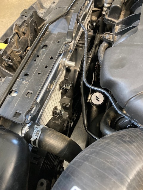

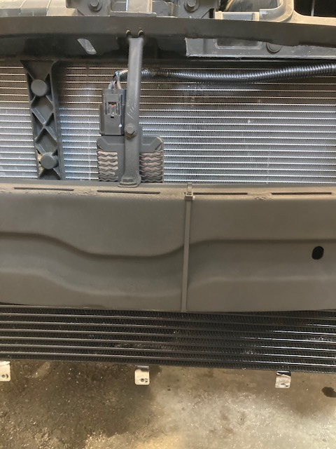

Update on the 11 sedan project. I got the front lower bar and RR motor mount installed. I also installed the rad with two 11" slim fans wired in parallel to the fan speed module. I relocated it to a cooler area hoping this will prolong its life. I will zip tie the wires up out of the way later before I put the bumper cover on. 1654356981150.png 1654357008215.png 1654357075439.png

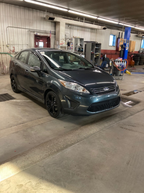

May I present to you, a 2011 FrankenBean ST sedan. Now let the real games begin. I need 300 hp asap. I don't want it, I need it. Yes, it's ugly and that's what will surprise a few. The only mods so far are upgraded intake, hot and cold pipes, symposer delete, mishi FMIC and AP that I haven't plugged in yet. Now that I put around 100 miles on it and no warning lights came on, it's time for big turbo. Should I also go with 30% injectors and a higher volume HPFP or go single injector with stand alone ecu/harness? There is no room for a 4 port because the fan on the pass side just clears the intake pipe by millimeters. Originally it was rubbing but I loosened the clamps on the TB and spaced it away from the fan with my prybar and then tightened the clamps. I love this bean. It now has sync3 and apple car play works great. I love streaming pandora while using the waze app. Now I can merge onto the freeway no problem and every time I look down, I'm going 80 mph or more like it's nothing. 1654650339921.png

I'm not even a fan of the fiesta sedan body and I still think that is one of the coolest swaps ever! That car is so sick! Thanks for sharing your build process with us as well!
14,812
7,271
The wheels are the only thing that betrays the whole sleeper thing.
But, it could be seen as someone just going for an upgraded wheel for aesthetics, within the whole model line choice thing.
Even when you install tires which can handle the 300 ponies you need, anyone would have to look hard to really see them, and think "oh, sleeper". [wink]

People that "know" an ST versus the plain jane sedan will notice the rear disc brakes versus drums as well. Then they may also notice the syn3 screen that shows ST and Ford Performance when it wakes up or goes to sleep. They may also notice the 6 speed and the ST on the seats if they look inside. I haven't decided to put the Recaros yet because these seats are in such good condition. The front end of my sedan looks like a catfish or bubba gump so I'm wondering if there is anything I can to do improve that other then doing a front clip swap from a real ST. That would really give it away. BTW the rear seats on an ST have the center seatbelt retractor built into the seat and the sedan is built into the rear package shelf. I just pulled the ST center seatbelt all the way out and cut it so it retracted back inside itself.

While I agree that a fiesta enthusiast could spot the differences, I think people aren't going to expect a sedan swap. I would consider myself a fiesta enthusiast and even I don't really give the sedans much thought unless I happen to notice that it's a 5 speed. The biggest thing that would jump out to me about yours is the ST rims.
14,812
7,271
TRUE!
VERY few are going to bother to look inside to see a manual, or ST seats/screen, and the strongest legal in Pennsyltucky tint would take care of that anyway. [wink]
The ST front bumper/clip would be cool, and REALLY confuse even an ST 'enthusiast'. [:)]
