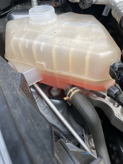

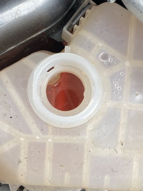

I purchased the motor craft yellow coolant to top off my coolant since it was low. When I went to do it I realized it looks pink rather than orange. Is this normal, or did the previous owner flush and add new coolant?
11,516
8,009
You can use either of those yellow or orange/pink coolant. They can also be combined/ mixed without any issues as per Fords TSB.

That was the color my coolant was when I drained it. is that the "bad" reservoir that was recalled? I've never seen that one before, I have an egg shaped one.
D1JL
7000 Post Club
Staff Member
U.S. Navy Veteran
7,835
4,074
SFV, So.Cal.
I believe all the new coolant from Ford is Yellow.
YES, but only if the 17S09 recall was required for certain '14-'15 cars.
