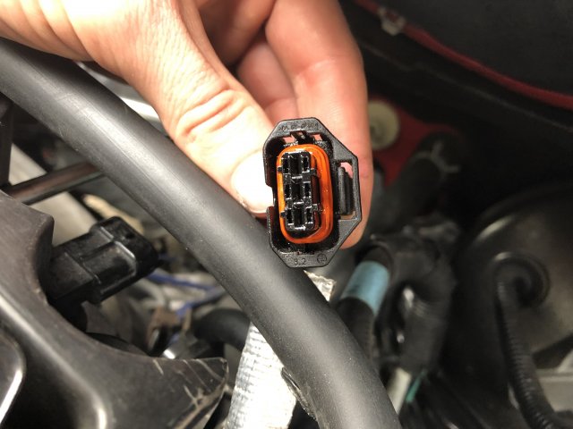

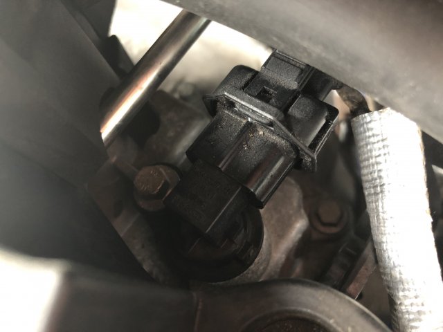

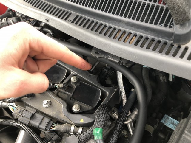

so im getting closer to identifying this issue. i took some time to look over all connections and hoses and found something very odd. first i did a test to identify exactly what fuse 24 directly regulates by pulling the fuse and checking the codes. p025a and u0109 (i believe). long story short i cleared the codes, put the fuse back, and disconnected a connector for the fuel system (not entirely sure what it is but more on that later). check the codes and they are identical. im gonna post some pics so you can see what im talking about.

pic 3 (wet from either oil or gas)
Clean it up with electramotive or contact cleaner and put some dielectric grease on it and send it.

sorry for individual pics, my phone is weird.
took me WAY too long to figure out that this is exhaust cam position sensor. is there any reason the connector would be this wet? and would that cause the fuse to blow?

How much rain have you gotten recently? Maybe the cowl isnt sealing right on its edge to the windshield or hood??

a bit but the connector, at least, had oil in it. honestly im to the point where if i cant figure this out ill just have my dealer fix it and pay the deductible. everyone on here has been super helpful but im stumped

Hmm how did that get oil in it?? I wonder if an oil seal on the sensor failed and it fed through the body of it into the plug. It looks clean all the way around it.
