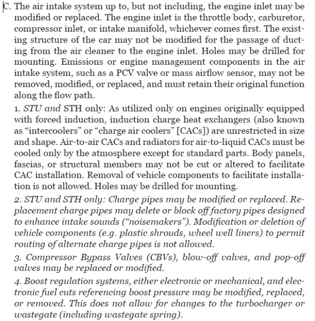

Street touring allows both radiator and intercooler to be upgraded on the Fiesta, but not the charge pipes.
edit 8/11/2021:
So it seems the edition of the rules released on 6/24/2021 allows charge pipes in STH and STH, as well as BOV/DV+/diverter vales, etc.
