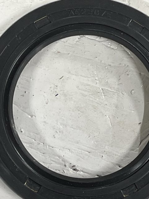

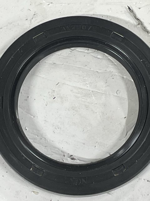

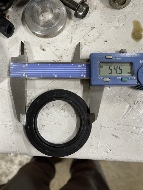

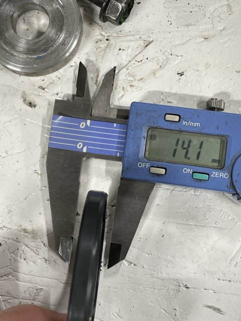

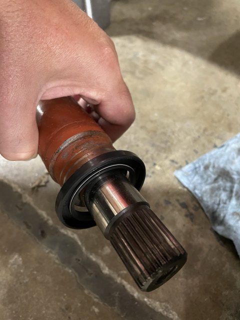

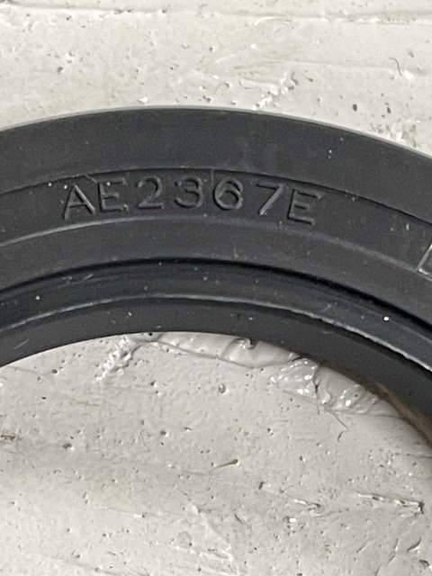

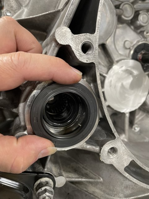

Don't buy Timken 710443 Axle Seals, They are wrong

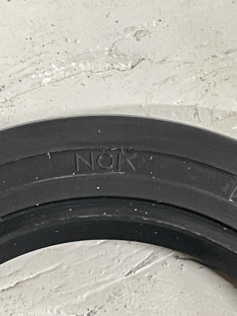

I ordered some Motorcraft axle seals from Rock Auto. They work and are correct. The Motorcraft number is BRS-174. They actually showed up with the OEM Ford number on the front of the MC bag. CV6Z-1S177-A. Apparently the OEM seal is made in Spain.
