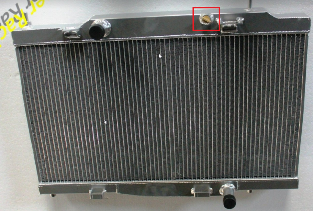

@[B]draxxus131[/B] Hey mate just got the Chinese radiator that you got as well. Can you confirm that the bleeding valve should be at the top? Radiator should be mounted like bellow with the bleeding valve at the top?
A bleeder valve wouldn't work very well on the bottom, if that helps any.
14
Athens, Greece
#34
Most of the radiators i have seen have the bleeder valve at the bottom. Also i tested my OEM shroud and it attaches correctly with the valve being at the top. On the other hand those chineese guys in their auction have picks with the valve being at the bottom. Check bellow, thats why i asked to make sure correct fitment.
