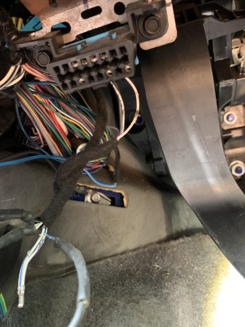

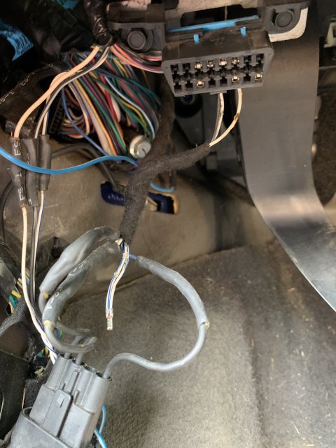

Okay, I’ve had some recent demons pop up in my 2014, it’s got 123,000 miles and started throwing the P1299 code. It’s not overheating, I replaced the sensor, and it’s still throwing the code. I was able to read the code with a wifi code reader but that has since stopped working, I had a shop try and pull/clear and they couldn’t get any communication with the ECU either. All that said, I’ve done a crap ton of research and believe my issue isn’t with the sensor but electrical system/OBD2 port in general causing grounding issues.
After reading a post somewhere about part of the recall on the coolant system adding a wire to the OBD2 port, I started investigating there and found this hot mess.
I need some advice on how to address this with the dealership to get it fixed. There are burnt/cracking wires on the harness likely from the modifications they did for the recall. Does anyone have a comparison picture of the same wires?
I’ve never used any aftermarket tunes or access ports (outside the wifi OBD2 reader briefly to read the codes), and it’s 100% stock.
If the car had the 17S09 recall done and you believe you are having electrical issues from that recall.
Don't mess with it, just take it to the dealer.

Thank you! Using that recall code I was able to find the documentation for the recall and pinpoint that it’s the exact work they did. Recall was done by previous owner in 2018 and probably about 40k miles ago. Not sure if it’s covered under the recall warranty, but it’s definitely all the splices and connections they did.
Now it’s time to argue with the service adviser at the dealership.

Thanks for all the advice and info. Since I’m at 123k miles and 3 years after the recall was done I didn’t feel like fighting Ford for a fix. (Plus local dealerships were assholes and had nearly a 2 month delay for service) I decided to fix the connector and wiring this morning. All seems well now. One of the pins in the stock connector broke and the wire had come out/loose. Got a 4 pin auto/marine quality connector from auto zone and spliced it in seemlessly.
Thanks again for the help!
