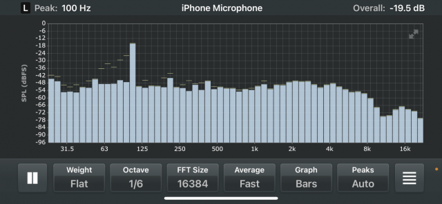

Alrighty... So here we go, in case anyone wonders if Milltek Sport resonated catback exhaust may drone for them - yes it may. YMMV depending on how sensitive your ears are, but it does for me. It's doesn't hit you like a hammer, but if I keep it just over that notorious 3k RPM, my ears start feeling noticeable pressure. Came home from driving the car for an hour or so and ears are definitely feeling it. I am using poly hangers, so maybe switching to stock rubber ones will help... otherwise I think it's back to stock for me. Real shame, because the volume was pretty much perfect.
EDIT: Measured sound at 3k, you can see the 100Hz peak

Following the advice of a few folks here, I replaced the two front-most (near downpipe) whoosh insulators back to stock ones (fyi blue one now apparently comes in brown colour) and I can confirm that it makes a lot of difference. Cabin noise level / drone / vibrations went down significantly. There's still boom at 3k but I feel like it doesn't bother my ears as much anymore and so I think the car is now daily drivable again.

I ended up replacing the remaining rear-most poly hangers with stock ones and I am now a firm believer that Ford used what they used for a good reason. Maybe it's because the car body is so rigid that it turns into a big speaker otherwise, especially with larger-than-stock diameter. I can definitely recommend anyone with exhaust drone issues to try stock hangers first. Exhaust shop I used addressed the issue where exhaust would swing side to side by welding on an extra hanger and using the bolt that holds the handbrake cable (I think?) as the other mount point, through a rubber insulator (and I guess Thermal one shouldn't be suffering from that because they already have a fixed mounting point on the crossbar).
