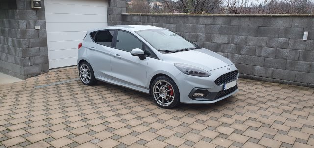

All used wheels I could get were damaged. Eventually I have ordered Autec Clubracing in silver. They are super light (7.7kg) and made with flow forming so should be a bit more sturdier and are TÜV certified. The dealer even rewarded me with safety bolts. I am looking forward to them, I will post a picture when they arrive.

As promised, attaching a picture with the new wheels. To be honest I was expecting them to look better on the car xD But the more I look at it the better they look.
Autec Clubracing Silver 17x7,5 ET38

^^^Those would actually look really good in white (and more 'rally-like' as well), despite being a major b**** to keep clean.
Anthracite/charcoal would also look good on that color Mk8. [wink]
