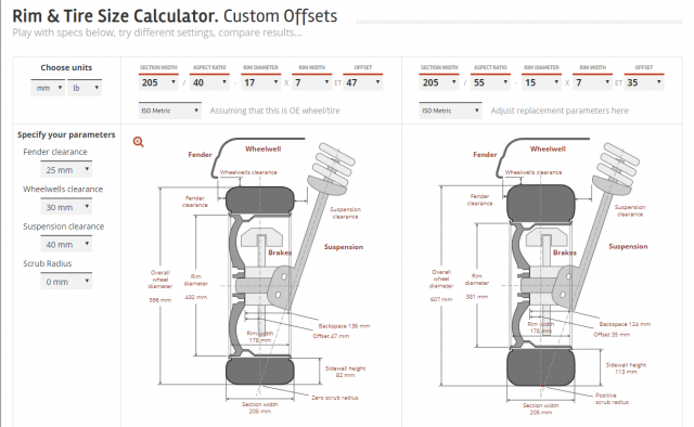

Has anyone taken these dimensions off the stock wheel and tire setup? Referring to the stock fender clearance, wheelwells clearance, suspension clearance, & scrub radius. This is a useful tool to explore wheel and tire arrangements on this car. 1587400898717.png

Thinking about going widebody. Anyone think 215/40R17 on 17x8ET0 will fit stock? And stock meaning no aftermarket suspension, spacers, etc.
I haven't taken huge measurements, but I have used that tool to check and visualize wheel and tire sizes and fitment over stock.
