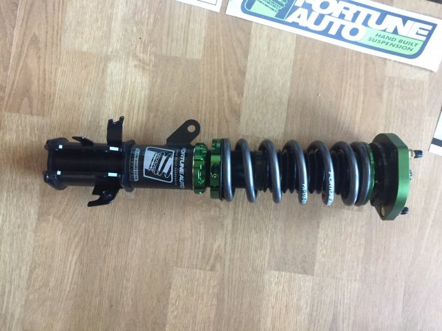

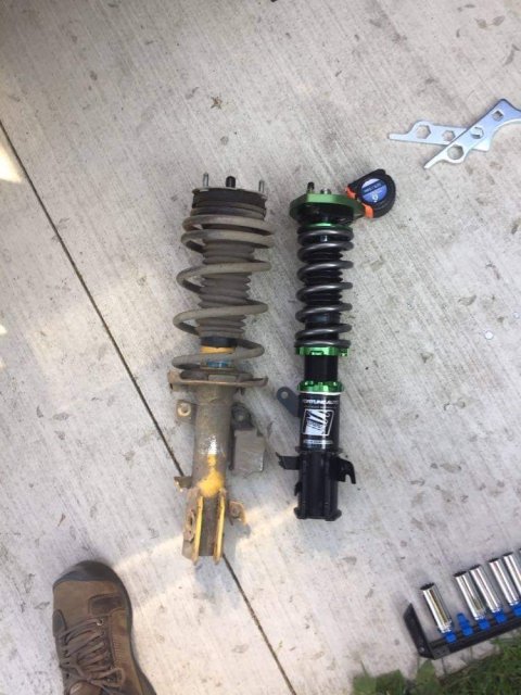

Just had a mini Christmas with a couple boxes showing up at my doorstep. The first was from Rock Auto- I bought a pair of new control arms to have new poly bushings put in. the second box was the big one from Fortune Auto. They were really helpful and patient talking me through the spring selection and various choices. I went with the FA branded springs in 7k front/5k rear rates, and went for the Whiteline camber bolt add-on, as I haven't been super happy with the -1.5 degree front camber I was able to get in the front on the H&R camber bolts I have on now. It took about 5 weeks to get them built because of Covid madness, and then about a week to get up here to Alaska.
They are so much prettier than the Swift/Bilstein setup I am running now- I can't wait for my control arms to get done so I can put them on.
View attachment 33171 View attachment 33173

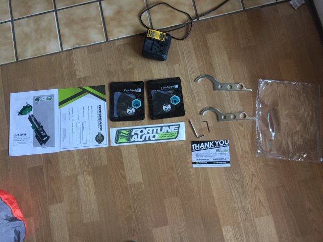

I was really impressed with the packaging- each piece was securely bubble wrapped and foam blocked into place inside the thick double boxes.
They came with a manual, build certificate, spanners, allen keys for the adjuster knob and locking perches, a thank you card, a bumper sticker, and two FA branded masks.

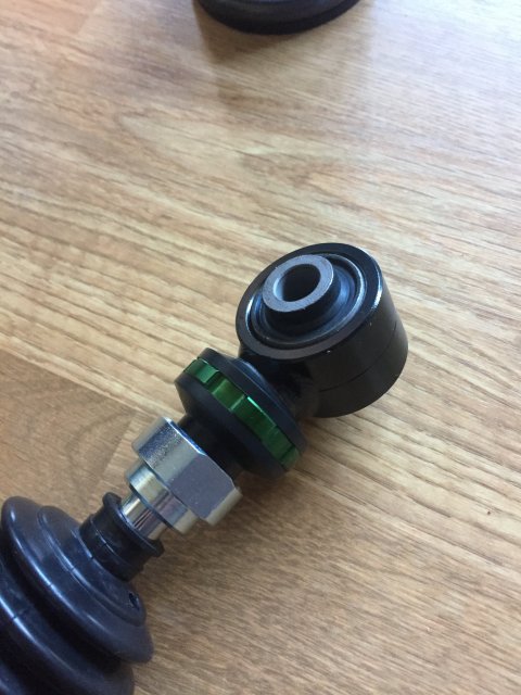

The small green anodized collar is an adjuster for the rear shocks.
See this, Koni? This is how rear shock adjustments should be done, you Dutch weirdos. None of this "remove the shock from the car, stick it in a vice, pull it to its full limit and rotate the unmarked shiny shaft some indeterminate amount before putting the shock back on the car and testing" bulllshit.

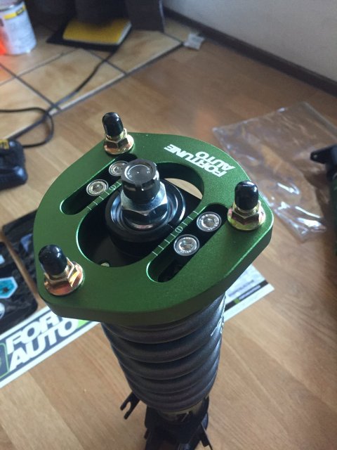

WTF?! (in a good way!)
What happened to my camber bolts? Granted, I'd much rather have these plates, but I was a little surprised and will email to be sure these are the correct bits.

Just got an email back from Devin, the rep I have been working with at Fortune- the camber plates have just finished testing and are now included.
I'm a big fan of the responsive customer service- they get back to you within a couple hours, or at the latest the next day (time zones and whatnot).
I also got camber plates with mine and I was super surprised. Mine were the first set besides the guy who tested them, and it looks like you got the right adjuster knobs to go with yours as well! (they sent mine after the fact lol).
