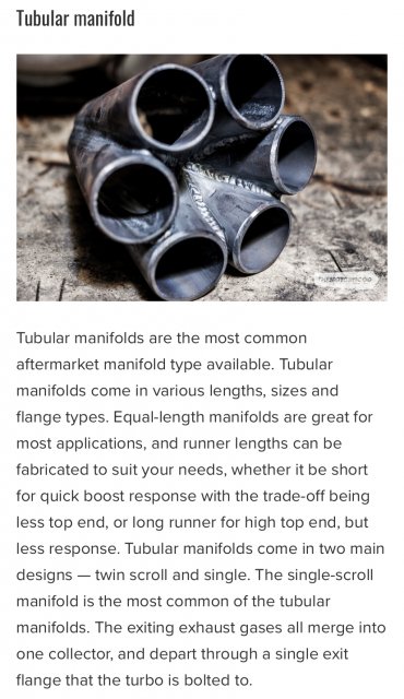

Thread Starter #34
So question, can anyone explain to me the primary benefit of a short vs long runner style exhaust manifold? Example, the Peron setup I purchased has a tubular long style turbo manifold and let’s say the puma speed manifold has a shorter style manifold.... or a ported stock manifold vs long tube exhaust manifold. Does the Peron / Nortech manifold that I purchased add specific gains to top end power but sacrifice low rpm response and loss in spool time? How does all that work? Pros and cons etc
MagnetiseST
1,318
1,166
Dania Beach
#36
Yeah, and like I said you'd want longer ones. You'd probably want to shift the power higher vs lower, especially shooting for the numbers you want. IMO you'll want to make peak tq around 4k and peak power around 5500 then have it taper off. It really depends on what the G25-550 can do.

Thread Starter #37
Fortunately, the nortech turbo manifold is built pretty long. Not sidewinder long but I believe the longest of stock location setup that’s currently offered. Interestingly enough the puma speed turbo setup is reverse rotation G25-550... apparently this helps spool as well when accompanied with the shorter runners in their kit? Not sure why reverse rotation would have to do with anything benefiting?? Just spins the other way....
so, the peron setup is standard rotation g25-550, which I’m actually grateful for because it gives me greater options for turbos in the future if need be. The g25-550 should see full power at roughly 3500-3700rpm... hoping to be able to increase the rpm range to hang in a little longer.
desired to pull to 7500-8rpm. Not sure if the head/motor can be built to handle 8k? Anyone know?
