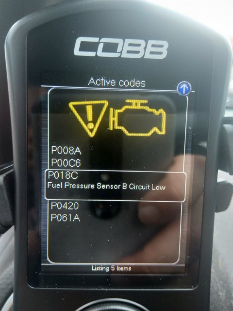

So I've recently added the uprated injectors and xdi HpFp to my fiesta and I'm getting some codes. Not sure if it's do to a bad installation on my part or if it could be something else is wrong with the car.
It's been exactly 413.0 mi since the install and the car has actually been running just fine. I drive the car daily and I've have been checking the car consistently everyday before and after my drive just to make sure nothing was leaking or smoking. Only thing that even slightly worried me was the HpFp is much louder then the OEM pump. I have let the fuel get down pretty often which is what I do, but once it got so low the fuel light came on.

All the fuel scaling and pressures now need to be adjusted by your tuner*

I guess I'll wait to see what happens after the first revision is done. I gave the parts installed a look over as well as the rest of the motor and everything looks to be just fine. I just don't want fuel bursting out of the fuel rail while merging on the highway. :LOL:

Are you running those upgrades without a tune that accounts for them at all? If so, that would explain it.

No I had a tune ready before the parts were put on.

Man it's been over a week waiting on the first revision of my tune. I've also sent Jason a screenshot that day of the codes and asked him about it but no reply as of yet.

My first tune revision took about that long as well. Jason seems to be super busy but I'm on revision 5 right now and he's pretty consistently getting revisions back to me within a week of sending him the logs. Been sending them to him on Sunday and getting a revision the next Sunday.

Update: Got my revision .V1b and no codes whatsoever so happy about that. Another thing I'm very happy about is I'm getting 31+ mpg now. Since I drive all over the state due to my job I'm extra happy with dizzy tuning! 🙌
