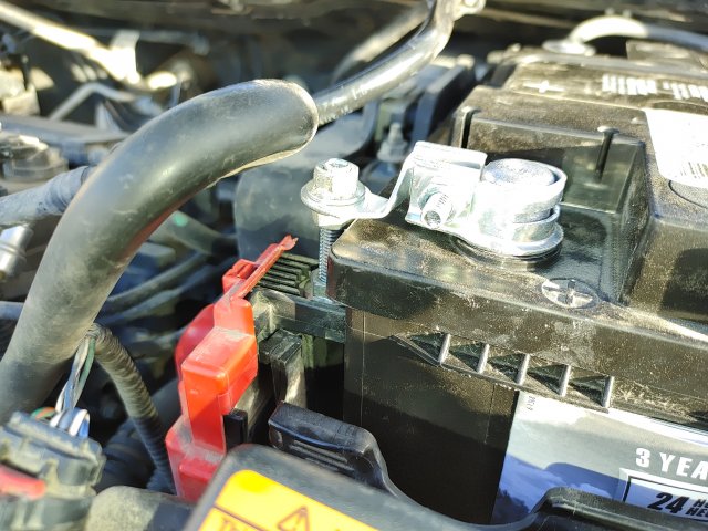

I know this is an old post, but does anyone have more photos of how the positive top mount post is setup after adding the group 47 battery which is 1/2" higher? I had to add a bolt in with 3 nuts to get the required height difference. My battery seems to be more than an inch taller.
