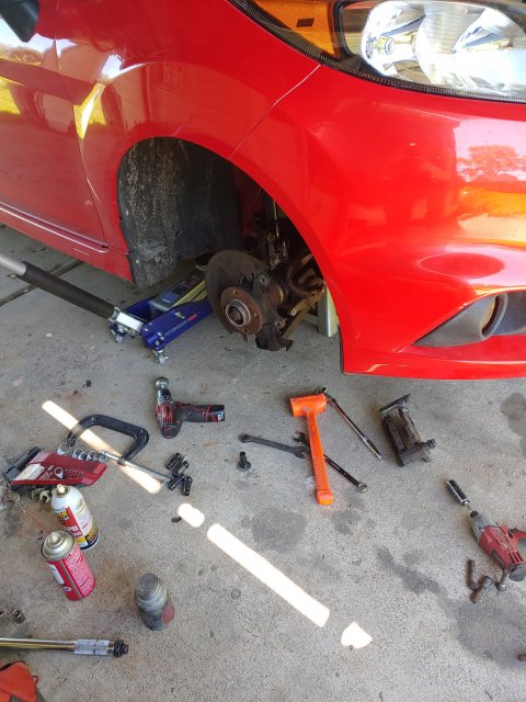

I did all 4 corners without pulling any hubs or dust shields. No fancy tools other than an open ended lug nut and a couple fat washers to keep from scoring the hub surface.
I pulled brake calipers and rotors to give me as much room as possible.
Popped one stud out at a time. (easiest space is right in front of the front hubs, maybe the back as well. Cant remember) i used a really big wrench on the other studs to hold the hub still while tightening the new wheel stud in place. Using PB blaster as a lubricant will make the job easier and not overly stretch the studs.
