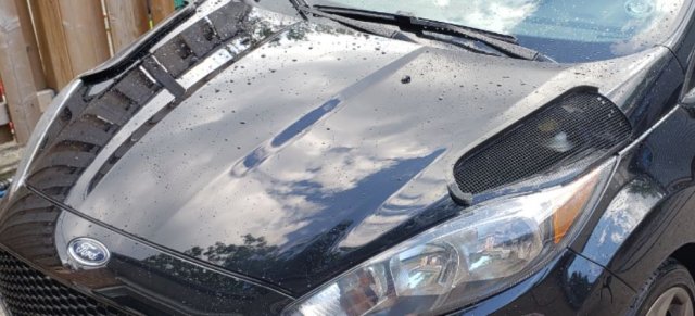

So, I've got my hood vents now.
They're not cheap and I'm thinking I may reproduce them for the future (in case I get in an accident etc) and I want to make some molds for carbon fiber reproductions.
Anyone interested in sets? Would remove the need to have them painted (at least I hope I can get the finish to an acceptable level).
