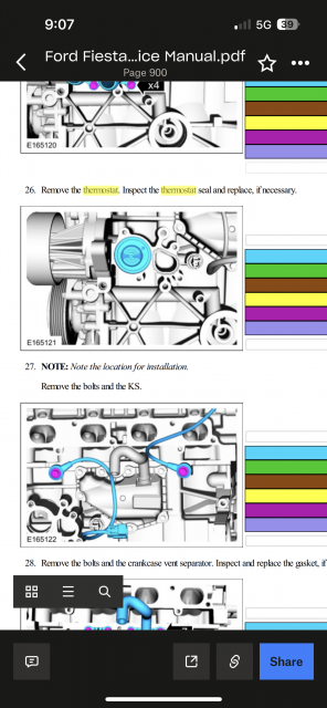

9) Now you just got remove the hold thermostat by pushing down and twisting the retainer. Then install the mishimoto thermostat the same way / position the old one is. Don’t forget to replace the gasket and make note of the position of the bubbler hole.

Thanks for this write up. Just made swapping my radiator & t-stat very easy! The only thing I needed a hand with is the tensioner pulley. I don’t have a 17 long enough to do it from the top and can’t put belt on from the bottom 🤣😂
